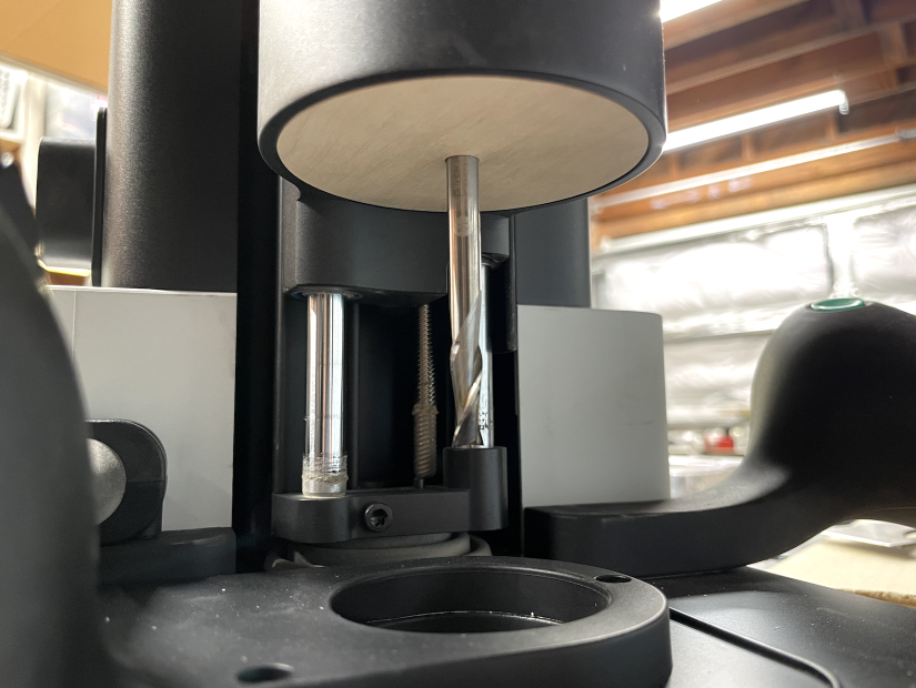

With swapping bits for gridding my current workflow interrupter, that got me thinking I could build a "dummy" spindle just for gridding.
I started off with a single 70mm diameter puck that has a nice friction fit:
I made a second puck that I can slide into the top so there's even pressure in the spindle lock when snugged.
I used a 1/4" bit to see how square the holes were. I'm sure with some patience I can get it more square than this.
I ordered some 8mm rods to use as my faux bit and a piece of acrylic tubing that has a 70mm OD to act as a spindle. The plan was to cut the tubing down to about 3", then put a couple pucks inside the tubing at the top and bottom for it to more closely mimic the size of the actual spindle. A single puck installed at the bottom of the spindle holder could become seated at an angle. A couple of pucks installed in the tubing would -- hopefully --remain square to the tubing and in the spindle holder.
Unfortunately, the diameter of the tubing is 70.56mm and that extra .56 makes a bit too much friction for easily sliding in and out of the spindle holder, even when the screw if fully loosened. It'll go, but requires a bit more pressure than I like.
I've got an idea to cut a kerf lengthwise in the tubing while adding slightly smaller diameter pucks. The kerf should allow the tubing to have a flexible diameter and "shrink" to the size of the pucks (65.90 diameter pucks and 2.05mm thick walls should get me back to 70mm). Fingers crossed. Also, the kerf will kinda act like the alignment channel that is on the existing spindle.
In hindsight, I probably would be just fine with a single puck. This is what I get for being an over-thinker. Ha [cool]

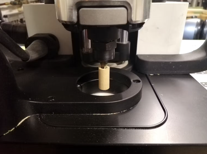

**Update**
Was looking around on Shaper Hub and found this very simple idea.
What I ended up with. Did a few test grids and it seems to be as accurate as gridding with the spindle. [cool]
I ordered a 4" long piece of drill rod on Amazon, way back when I first got the Origin. I just didn't like the backward bit thing, but it's only 1/4". It just seemed like the simplest way, since 1/4" is one of the default diameters in the selection screen. Sure, you could type in anything, but 1/4" is already there.

The tubing and stainless rod are from Amazon. The tubing is sold as 70mm OD (66 ID). There are many sellers to choose from. I ordered a 12" length.
As for the 8mm rod, it was available for next day delivery, same as the tubing, so I went with it. Almost instant gratification.  [big grin]

On that note, I had to make some changes. If you look at the earlier photo of the spindle mounted in the Origin, there's no way the rod will extend beyond the base when lowered.
When I made my grid tests, I hadn't seated the rod fully into the hole and there was only a couple mil extending beyond the base. I did a few more assemblies, fully seated the rod, taking the above pictures, but didn't do another test.
I was looking at the photo this morning and realized something looked off. I checked and the rod wasn't long enough to clear the base.
I made a couple changes, adding a longer rod, and some smaller pucks. This works much better:
There's now a slight discrepancy between gridding with the homemade spindle compared to the Origin spindle. I was placing a dot at the following coordinates:

[member=75283]4nthony[/member] The main reason I went with 1/4" was because it does double duty for setting the angle of my tilt base router. The scales on those things are notoriously bad, so I cut a piece of scrap to the correct angle on my mitersaw to compare.
In years past, I just used a long 1/4" flush-trim bit, but the smooth rod is much better. It cost me a whopping $2.68
