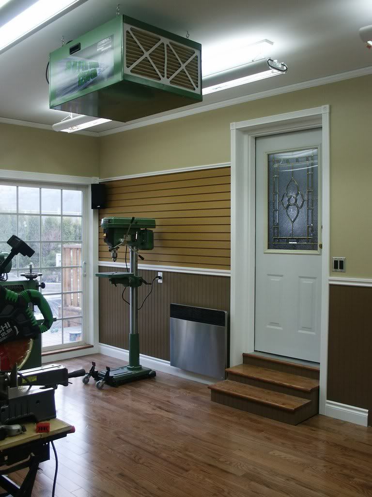

Nah you guys are all wimps Kinda like the English and Irish rugby teams when they come up against the NZ All Blacks [laughing]. Ive had hardwood oak with a satin finish in my shop for about 4yrs now. Do like to wear my vans skater shoes in shop. But even with dust does not seem to get slippery.
Lambeater.
Floor when it was first done a few years back
Floor now after some abuse

Your floor ain't laminate so how are we wimps.  I think you need to try out a laminate floor with some fine dust on it.
