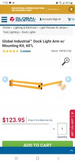

Here's one I've been looking at and just haven't  committed on it yet.  Looks like something you could make work and not all that expensive
