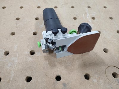

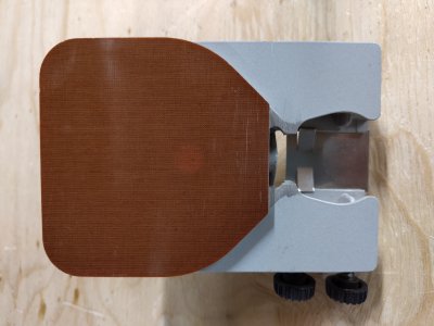

If you need to do a thickened edge the 0º horizontal base is the answer.
I have 3 700’s, different base on each one. Grab it one you need and do the trimming.
I wasn't aware that the EQ/B didn't come with the 1.5 degree horizontal base, but it makes sense, since it costs quite a bit less. As a cabinet maker, I would say that you could absolutely benefit from it, though it does depend on what kind of edging you use. The normal/vertical EB base is perfectly fine for the usual PVC and other thin edges.
Where I find the horizontal base to be the most useful, is with thicker hardwood edges, such as shelving.
"Theoretically" the vertical base and a planer type bit could flush up this kind of edge, but it is spinning the "wrong way"
Spinning circles on the surface is not the smoothest way to trim this. The horizontal base makes the bit act more like a planer or jointer, producing a much smoother cut.
I like the MFK700 so much that I have 2 of them. I keep the 0 degree base on one, set for wide edges, and the other can do whatever else I need from it. The offset of the handle/base makes the vertical base feel much more stable that the typical laminate trimmer.
As a cabinet maker, I wouldn't be without one. I use mine nearly every day.

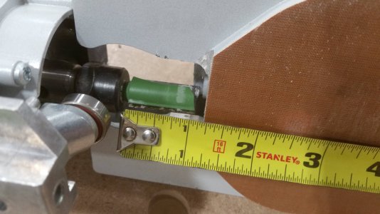

I had the same dilemma. One day using the vertical base with a planer bit and I immediately ordered the horizontal 0 degree base and a trimmer bit.
The planer bit would cause occasional splintering on edging, and was much harder to dial in especially on ply, as the cutter diameter is much larger thus increasing the likelihood of interacting with humps in the wood.
Horizontal base with the trimmer bit saw an immediate improvement in edge cut quality and faster, more accurate height adjustment. It’s also much more ergonomic to use giving superior control when pulling the router towards you on the first pass, a lot like a Japanese hand plane.
I still use the vertical base for edge profiles (roundovers, chamfers), thankfully it’s so quick and easy to swap between bases it’s no issue.
