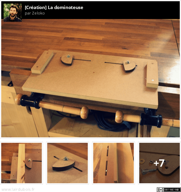

Hi Festool owners,
I've recently bought a Domino, and after a couple of weeks using it, I was bored to clamp my piece of wood on my workbench.
Then I remember a good idea and build this special clamping system. Maybe it can interest some of members.
Even if it is a basic build, I share the Sketchup plan on L'Air du Bois (a french woodworkers community).
Very cool.  Thanks for linking to the video that  inspired your build too.
Great jig! Did you do without a design; just ad hoc? Either way, still great.
Thank you for your comments !
#grbmds, I'm not sure to understand your question, but I did several build before this one to find the best position of each things according to my needs with the domino. But the idea of the eccentric clamp come from the video of Dave Bardin (link is in my first post).
