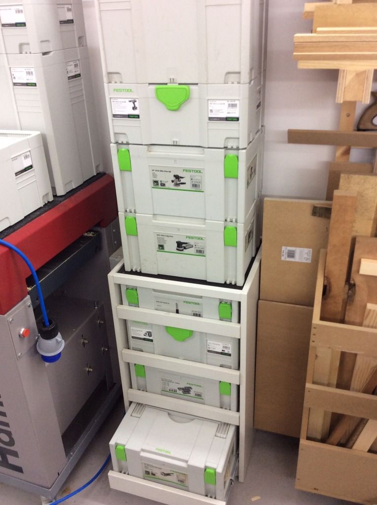

My problem is I don't have a lot of space, this is a cabinet I built a few years ago
As you can see Festool fever has taken hold & I've out grown my first effort slightly [embarassed]

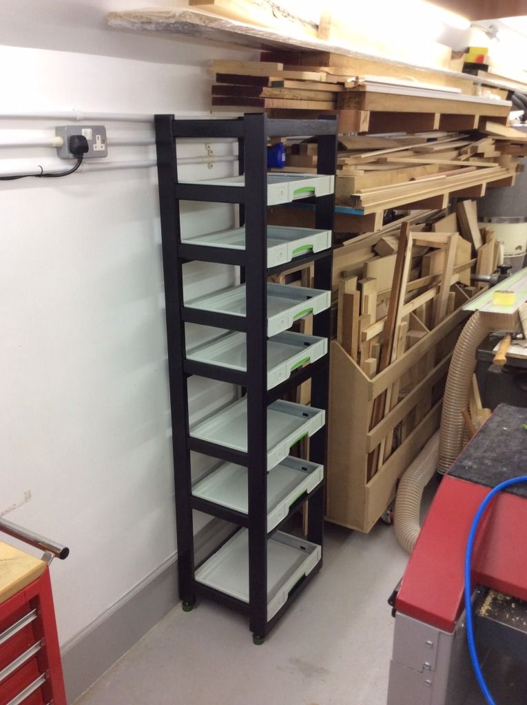

I needed to build something that fit in this space preferably out of materials I had to hand, so this is what I came up with.

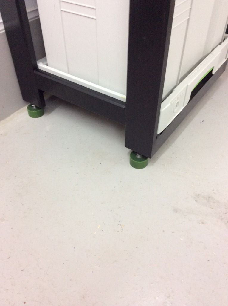

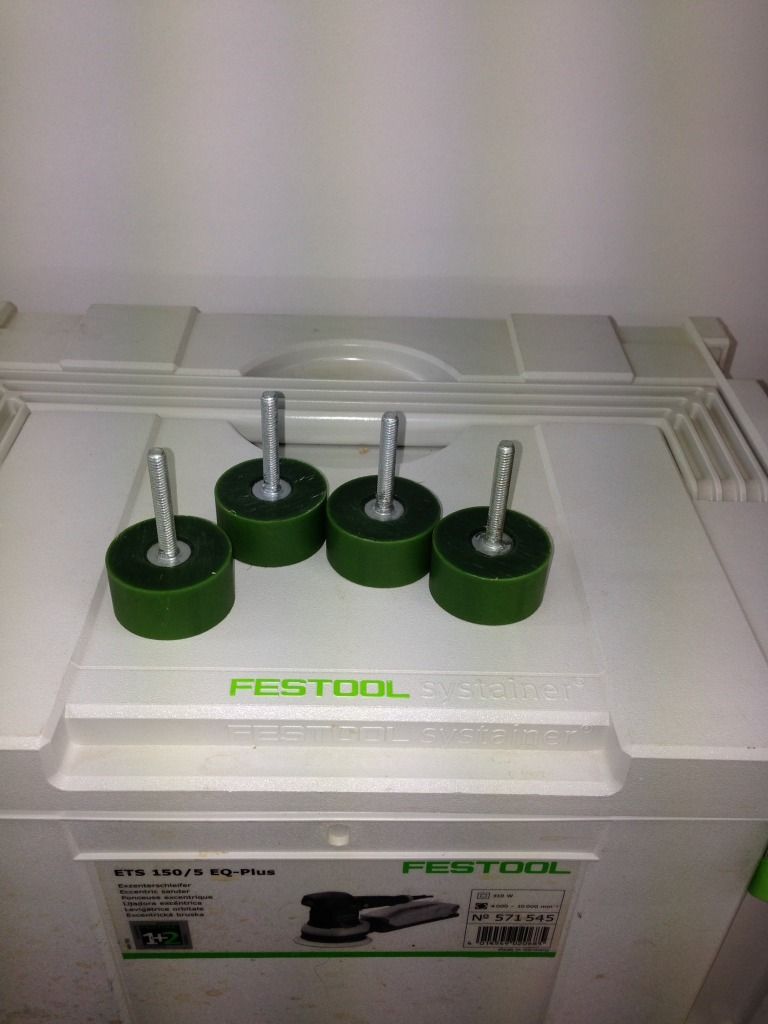

I realise this is higher than Festool recommend but not only is it fixed to the wall but I also made some locking adjustable feet so I could accurately level the unit.

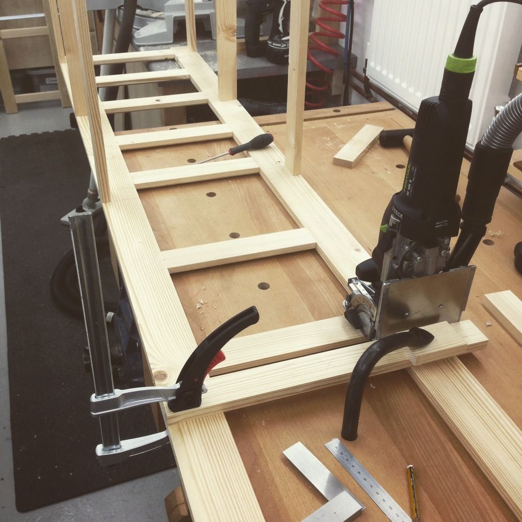

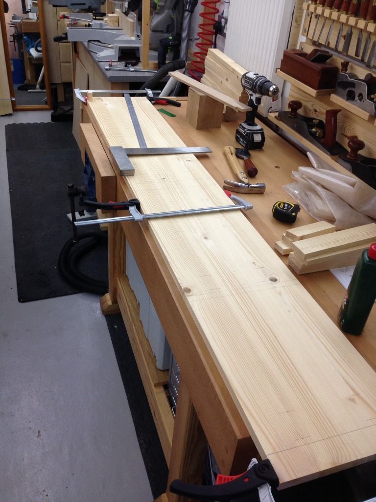

The frame is simply dominoed together & made from off cuts of pine joists, I took a few photos as I progressed these are they if anyone is interested.
Marking out

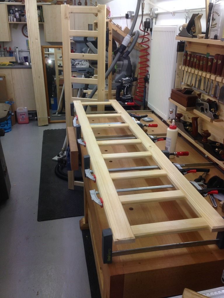

Gluing up the sides
Dominoing the rails

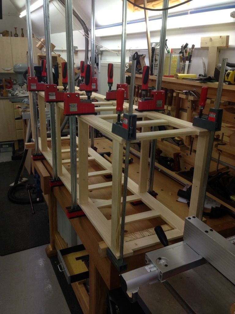

Final glue up

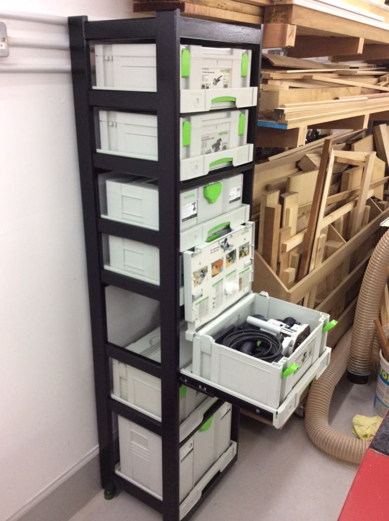

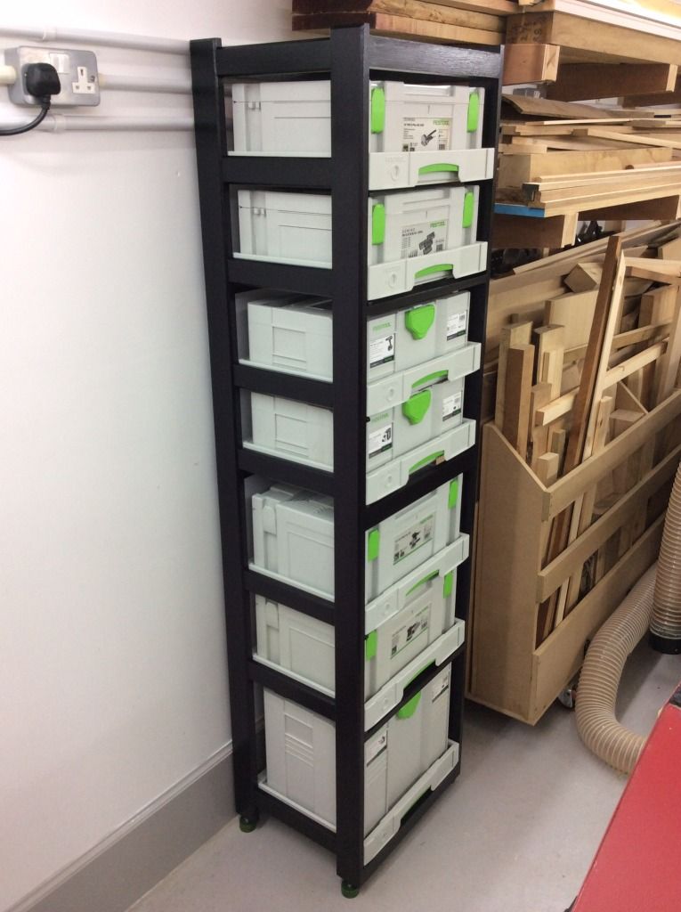

Lastly a couple of photos of the unit loaded up
Marking out
Gluing up the sides
Dominoing the rails
