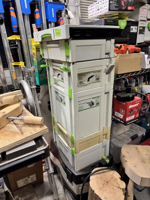

I have a few classic ones that are yellowed a bit too. I think it's mostly the sun-exposed ones or the ones closest to the TL lighting. By now there is more external shading, the place of the Systainer sit has changed and the TL lights were changed to LED.
But how fast yours have shifted color there must be something else going on. Chemistry wasn't my strong side, but what I read all reads rather plausible.

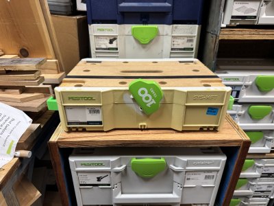

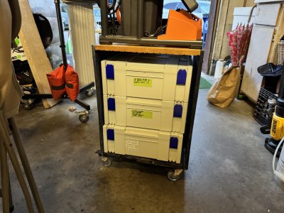

This is my SYS-MFT, it’s pretty yellowed and you can see that the top and under the latch is not. The TS55EQ has a little yellowing but not too heavy. The other T-Locs I have do not have this yellowing

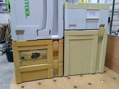

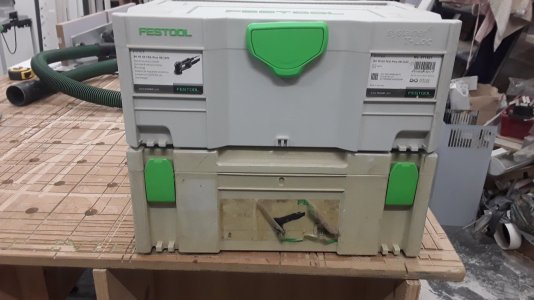

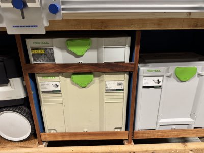

I’ve also got a few Classics. The Tanos ones are very white (they may not look like it because of the lighting) and the Festool ones range. One of them has the weakened latches.

@onocoffee That SYS-MFT is insane!
Did you let off a nearby nuke for it to go so yellow when it's the recent 100 year release?
Ha! I replaced the original latch with the SYS3 100th version since the original was also very yellowed!
I thought it was 100 years old, so the color seems appropriate.
I think it was actually uncovered at some ruins in Wendlingen...

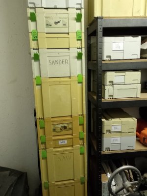

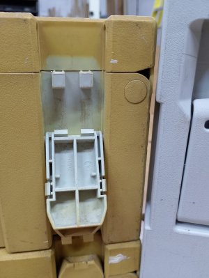

I have Systainers in all shades, these are mainly old ones which don't get used anymore.
I don't mind a bit of discolouration but the nicotine yellow isn't a great look (they are 20+ years old).
But still fine behind the latches
