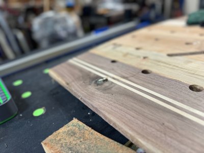

I finally had the chance to take both the RS 2 E and LS 130 EQ for a spin on a real project. Working on my outdoor workbench and it was Sanding Time. Used the RS 2 to keep it flat with P80 and P120 on both sides, then to P180 on the topside.
While using both the RS and LS, I found them to be jump around at times - much like an RO150 would do. The RS would be gliding along and then suddenly, jump and make a hard left turn. I was trying to think about how I might be able to better control the sander. Now, I do have to note that after I finished with the RS 2, I noted some swirl marks and then realized that I forgot to turn down the suction. I ended up backing down to P120 Granat and re-sanding the top with the ETC EC 150/3, and that cleaned it up.
For the final sanding, I used P180 Grant on the LS 130 keeping the pad inline with the grain across the top. But like the RS 2, there were points where the LS would jump and skip. No left turns, just a bit of jumping - and typically in the same spot across the boards in the top. I thought it might be the way I was holding it and wondered if I might be pushing too hard on the top and leaning it forward, but I'm not sure.
At the end, I think the top looks good and is ready for finishing. Planning on using Waterlox as the workbench will live outside.

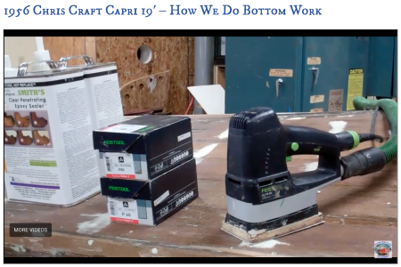

Snake Mountain Boatworks restores classic wooden boats and they use the LS 130 for initially fairing out the planking on the boats. After that they'll switch to a Hutchins 3800 16" long board sander to fully flatten the bottom and sides. The LS 130 and Festool paper is shown at the 16:00 time stamp.

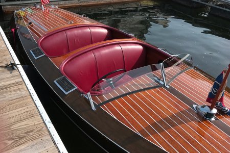

Here's an example of the quality of work he does, look at the reflection of the rear engine cover, not a ripple in it...we should be so lucky.
Ya, he's pretty straight forward and just speaks straight-away.
I watched from the point cheese linked. The guy didn’t show using the LS130. Note that when he says they never sand finer than 80 grit he’s talking about primitive bottom of the boat. Would like to know what the process is for the fine looking deck.
They usually apply a minimum of 20 coats of high build varnish and up to 30 coats depending upon the situation. They start by applying 3-4 coats of varnish and then block sand by hand to start to smooth things out. Remember, all the planking has previously been faired smooth with the LS 130 & Hutchins long board sanders so now it's just the varnish that needs to be worked.
Block sand with 120...apply 3-4 coats of varnish...block sand with 180...apply 3-4 coats of varnish...block sand with ???...this continues until they're finally block sanding with 400 grit. After each sanding session they wipe the entire sanded surface with acetone. After they've completed the 400 stage, then it's wet block sanding with 1000, 1200 & 1500 grit. Then buffing the surface to produce the required sheen. It's not unlike producing a custom car or motorcycle finish but on wood instead of metal.
Here's how they use the LS 130...it starts at the 1:00 mark.
And here's some interesting videos on sanding and buffing the varnish.
@ onocoffee in the video above the guy is using muscle in both arms to hold the LS130 (loaded with 40 grit) down on the surface to sand the high spots in order to bring up the valleys. So take what I said with a grain of salt and do some more testing on your own.
