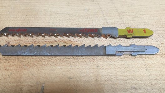

For cutting out circles using the Mafell with a Trion badged blade, if you force feed the Mafell, the blade will still deflect very slightly...let the machine do the work. For straight cutting, perpendicularity is not an issue with the Trion blade. If you want the maximum in blade stiffness then use the Mafell W1 blade. It's actually 2 blades silver soldered together.
Though it comes in 2nd place, the Trion is an extremely capable jig saw and with a little care and common sense, the cut will be very perpendicular. If you don't want to spend almost $800 on a jig saw, the Trion at $300 is a steal. The Carvex is a mess.

Not even the Mafell P1 can cut straight with an ordinary narrow kerf blade.
The best upgrade for any jigsaw is to use the Mafell double wide blade, but it may cause too much strain for a lot of them.

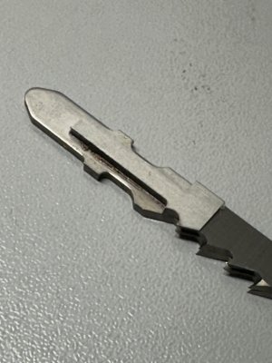

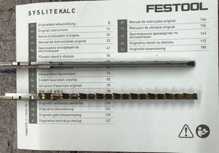

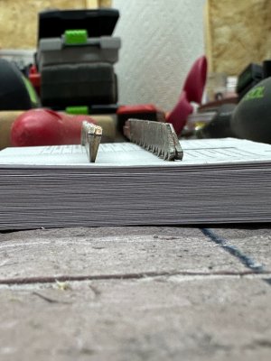

Here's a couple of better photos of the Mafell W1 blade. The kerf of the blade is 2.98 mm however it tapers to only 1.16 mm at the back edge of the blade for cutting curves.
In comparison, the thickest Festool blade has a kerf of 2.00 mm and a back edge thickness of 1.30 mm. That is the gold colored Trion marked blade S 74/4 FSG...486551.

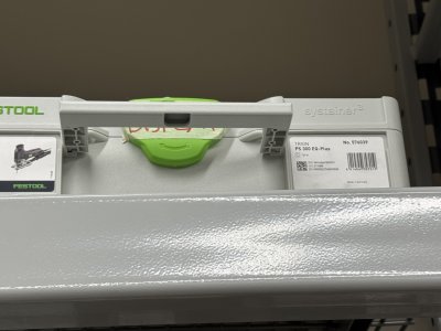

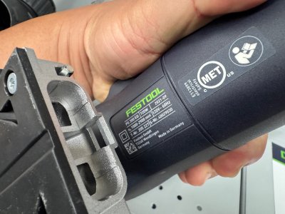

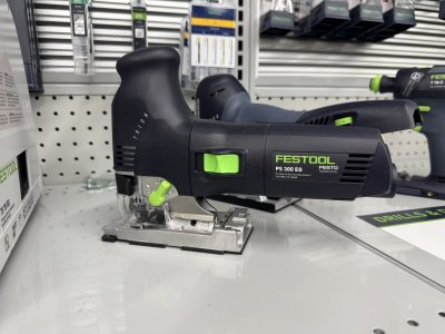

Well, I am just leaving Hingham Lumber in Hingham, Massachusetts and they have at least one PS300. 2021 build in a SYS3. This is the display model. It looks clean and they said that if that’s the last one, they would sell it. And I think the MSRP is $315.
Better call them now and grab it up!
@Cheese, thanks for checking that! I’ve wanted to be able to cut a dead straight line with a jigsaw for decades. Thought I bought the ticket 40 years ago when the Bosch 1584 DVS came out. It was the first jigsaw that (I know of) purported to be capable of being run along a straight edge. I never found a blade with enough set (until the W1) that could tolerate the degree of unparallelness between the axis of the blade and the shoe of the saw. I’ll try that gold Festool blade.
I have the track adapter for my Trion. I've only used it a few times, but it does work. With a sharp blade and a slow, steady cut, it's "reasonably" accurate.
How far can you go? If more than a foot you have an exceptional saw.
I have several jigsaws including the Trion and Mafell and the blade simply isn’t close enough to parallel to the base to allow the cut to continue very far.
When I tried track cutting with the Mafell I didn’t use a heavy set blade. I’ll try again with the gold blade Cheese called out but if you have to use a coarse blade it kinda (sometimes) defeats the purpose.
