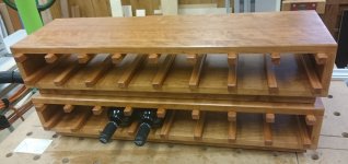

jcrowe1950 said:I am considering trying to adapt the Festool Surfix system to use with various Osmo products. Since both are hard wax finishes, differing in oils used and waxes used, I am interested in seeing how the process works with Osmo. Essentially the process is to sand raw wood to 180, apply the first coat of finish, let it soak in for fifteen minutes and then use a ROS (for me an ETS EC 150/5) with the green vlies pad to buff the finish in. Then, use an absorbent cloth to wipe off excess finish. After a cure time of eight hours (or more for some conditions), sand with Granat 220 followed by another thin coat of finish....let it absorb for fifteen minutes and buff it with the white vlies (non-woven abrasive equivalent to 0000 steel wool without the metal bits) and wipe off the excess. The actual Surfix oil I like OK but it's a bit too matte for my tastes
Whenever I've used Surfix, both Outdoor & One-Step, I've always used the green pad & the white pad on a Rotex 125 in the gear driven Rotex mode. That seems to produce a bit more sheen especially when using the white pad.
