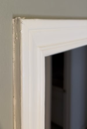

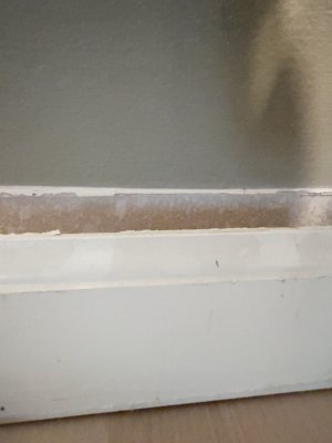

I apologize for not being more clear, The floor is vinyl plank, I'm trying to sand 3 inch baseboard molding , and trim around doors, not the floor itself.

I take it you are trying to keep the original trim…I see very little help from the “machine” (flat surfaces..yes) soft pads just round over details and there will be a lot of hand sanding -after stripping that old paint-
If the original detail is not really important, the crisp details of new trim will leave more time for other work and make all this go much faster, plus make you smile …next to your super smooth walls
Well yes sort of….thats why I was careful not to just say, replace it with new…when you have unique or custom trim and want to save it there is a lot of hand- finessing- stripping, (often several coats in an older house) ,to be done. Trim is often soft wood(s) and sanding can remove/soften crisp details.
So yes…the basic steps..prime, install, fill nail holes, apply finish until happy with the coverage

I have found that a decent sanding block and appropriate grit selection can make fast work of the trim like the ones pictured.
I use the Gator-style moulded foam sanding blocks. I have them in three sizes. The original one was a genuine Gator, the rest are Amazon-purchased knock offs. They all work about the same.
Gator sand paper is pretty good, but not cheap. I buy roles of sand paper from Amazon to use with these.
In any case, I think you will find that the job is not so labor intensive if you have the right sanding block and the right grit selection. The sanding blocks are light weight, have no trailing electric cords and will do the job in short order. They will also drop all the dust directly below and very little will remain airborne.

As far as the original trim is concerned, you might go The Difficult Way - see if you can find a used LS130 sander, buy that and get the contour pad for it. This allows you to shape a pad to the exact shape of the trim you need to sand. I say this is The Difficult Way because the LS130 has been discontinued for quite a few years now but they do come up in the used market from time to time.
Regarding the interior trim in the pictures above, I highly recommend replacing it. Those are just standard profiles available everywhere, so it's not like you need to preserve some custom profile that's hard to replace. Sanding (via whatever method you choose) is going to be a pain.
Another thing to keep in mind is whether there's a globbed up paint line between the wall and trim. That will leave a line when you remove the trim, so you either have to sand that flat or get a wider piece of trim to extend beyond it.

Ok, thanks, I'm thinking the same now that you explain it this way. Im buying more of my time back by replacing the trim than buying a tool just to "save" the old trim. Which it has splintered wood in parts, I contemplated wood filer, but that doesn't make since either.
A carbide tipped scraper will make quick work of the paint build up. A light sanding after will leave it smooth.
The video looks like one of those TV ads, but my experience is that they work almost as well as the video. The paint on the door was probably over a clear varnish which is why it is scraping so clean. But it removes paint build up and there is very little dust.
Get the type that works on the “draw” (pull). Most have cheap, replaceable blades. I have one that uses triangular blades about 3/4” per side and it is very good for detail work. My other scraper takes blades about 3” wide. Use light pressure so that you don’t remove any of the underlying wood.
