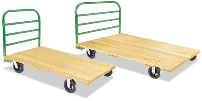

I think a rolling dolly with the added plywood back, would give you the best chance at success.  Here is an example:
https://www.uline.com/BL_1817/Wood-Platform-Trucks?keywords=flat+cart+dolly
HD10_1817
