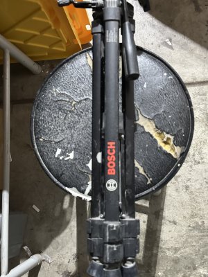

The Bosch laser tripod is nice, I don’t think it will fit in a Systainer collapsed, but worth considering.

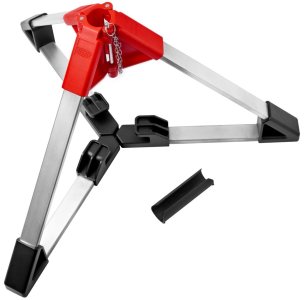

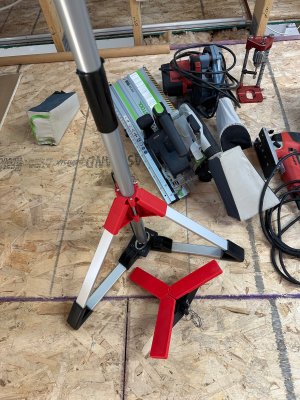

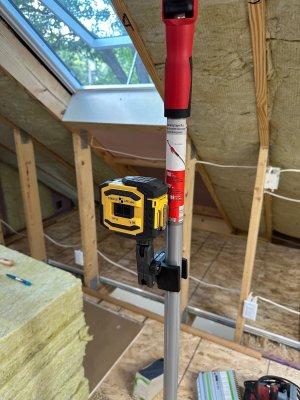

Bessey offers a laser clamp STE-LH that clamps to various materials and shapes. I use it with a Bessey tripod base STE-BS and a drywall support STE300. The tripod base is collapsible and will fit in a systainer along with the STE-LH and possibly the new drywall support STE55.
Bessey also offers a new smaller tripod base STE-KBS specifically for the STE55. It just depends on what your needs are.
Here's the current Bessey laser catalog, at the bottom of the page under downloads and the STE-LH connected to a Stabila laser.

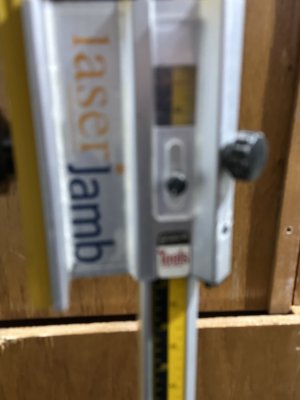

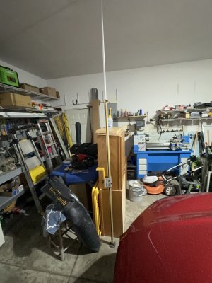

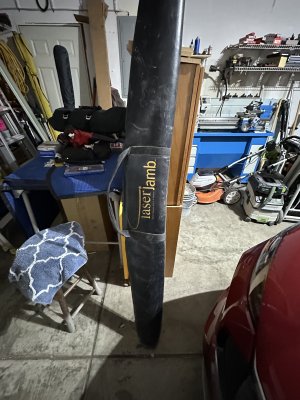

Back in ‘99 I bought the original style Laser Jamb, Use it to this day and would not trade it for 100 new ones, it is that far superior.
1999 Tools of the Trade, tool of the (I know I suck at tracking pictures….) .
Bosch tripod collapsed.

The floor to ceiling poles are interesting but I have very sloped ceilings that reach over 17' high along one wall.
Man, you're a few decades behind - camera tripods are now carbon fiber. Light AND don't resonate. After all, they make some tuning forks out of aluminum!
To solve the ceiling height issue, the pole gets clamped or strapped to something. I’ve used walls, ladders and 5 gallon buckets with water in them.
That's where the Bessey tripod stand that looks like a Christmas tree stand comes in. I can just move it around the garage and it supports the pole/Stabila in a vertical position.
My Laser Jamb will not fit in that stand. Nice idea though.
