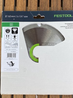

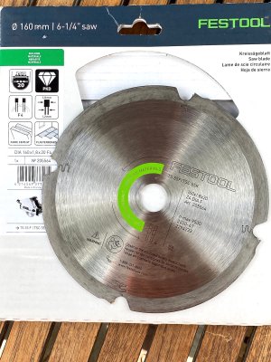

You'll get a nice clean cut using a diamond blade however, it's going to be a long haul using a TS 55. The cement pavers I've cut were slightly thicker than 2-1/4". I used a 14" Milwaukee 6180 abrasive chop saw and replaced the abrasive blade with a segmented diamond blade. Even that combination was slow. Also consider that the TS 55 has a maximum cutting depth of 50 mm (1.9") on a guide rail and those pavers are close to 60 mm thick.
Further, the Festool PKD diamond blade is not the one to use if you're using the saw off of a guide rail. Any sideways pressure placed on the saw flexes the blade and yanks the brazed-on teeth off. This was a new PKD diamond blade before I attempted to cut 8" of clay flue liner which is only 3/4" thick.

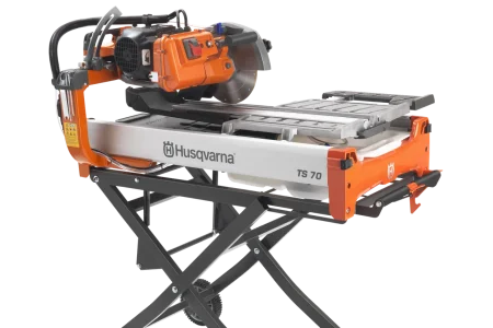

You'd normally use a wet saw which gives longer blade life because the blade is constantly cooled AND eliminates the dust because everything is wet. The dust elimination is a really big plus because when I was dry cutting the concrete pavers, I also set up a leaf blower to keep from breathing the dust and keep it away from my face. Dry cutting can be a real mess.
Just search for MK, Norton, Husqvarna, Ridgid...they all make wet cutters.
Rental is a good option if you can get everything laid out ahead of time to minimize rental costs. Menards, Home Depot, Ace are all good sources.
Rent a wet saw for pavers, most yards have them. Dry cutting 2 inches of masonry would probably smoke a TS55 and make an enormous mess.

Most tool rental places including the big box home improvement stores will have a wet saw available. Around here a 10 inch blade saw with a bit more power runs around $70 for 24 hour or under 300 for 7 days.
Harbor Freight has a decent wet saw as well 10 inch blade is around 500 and the 7 inch blade is around 300. Use at your leisure and resell afterwards.
My experience has been that the bridge style where the table slides is orders of magnitude better than the table saw style.
