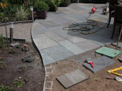

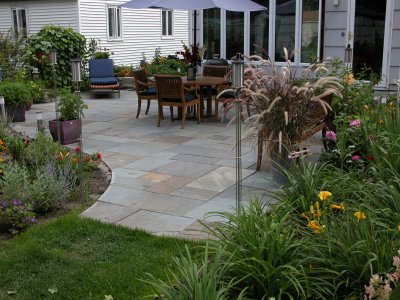

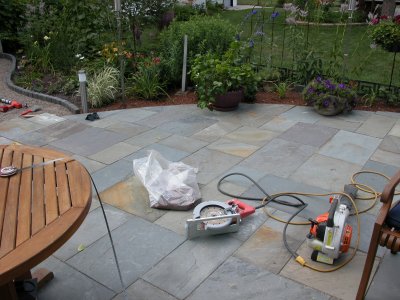

Picking up where RST left off... :) this is a Milwaukee 8-1/4" worm gear saw with a diamond blade that I used to cut New York Bluestone that varied from 1-1/2" to 2-1/4" thick. The Stihl blower was aimed at the blade as I was cutting to disperse the huge amount of dust that was being created. For dry cutting, the blower is mandatory.
