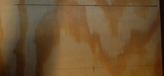

Hi Shane,
Below is a picture of the square and the lines you requested.  Everything seems to be fine with the square.  The square is brand-new, as I bought it a few days ago when I realized I was having problems.
Thanks...
[attachimg=#]
I meant referencing the square from the edge of your plywood, strike a line. Then flip and repeat. It looks like you drew a line to reference from, which isn't very accurate since you have to eyeball the alignment.
Can you try again? Thanks.
I can do that, but that would not be checking the square's  two outside edges, which are what I use to square up the table.  That method would check, for example, the outside long edge against the inside short edge.  But, I'll do it.  Thanks...

Hi Shane.  Please see below.  The lines lined up perfectly.  Thanks,
Ok, good.
So, it looks like your square isn't the issue.
And, we ruled out the saw being the issue.
I'd like to rule out the guide rail next. Can you repeat scribing a line on your rail on side of the rail OPPOSITE the side you checked before, flip and repeat. See if those align. If they do, your rail appears to be the problem because it aligns on one side and not on the other. If they do not, then your rail is not the issue.
