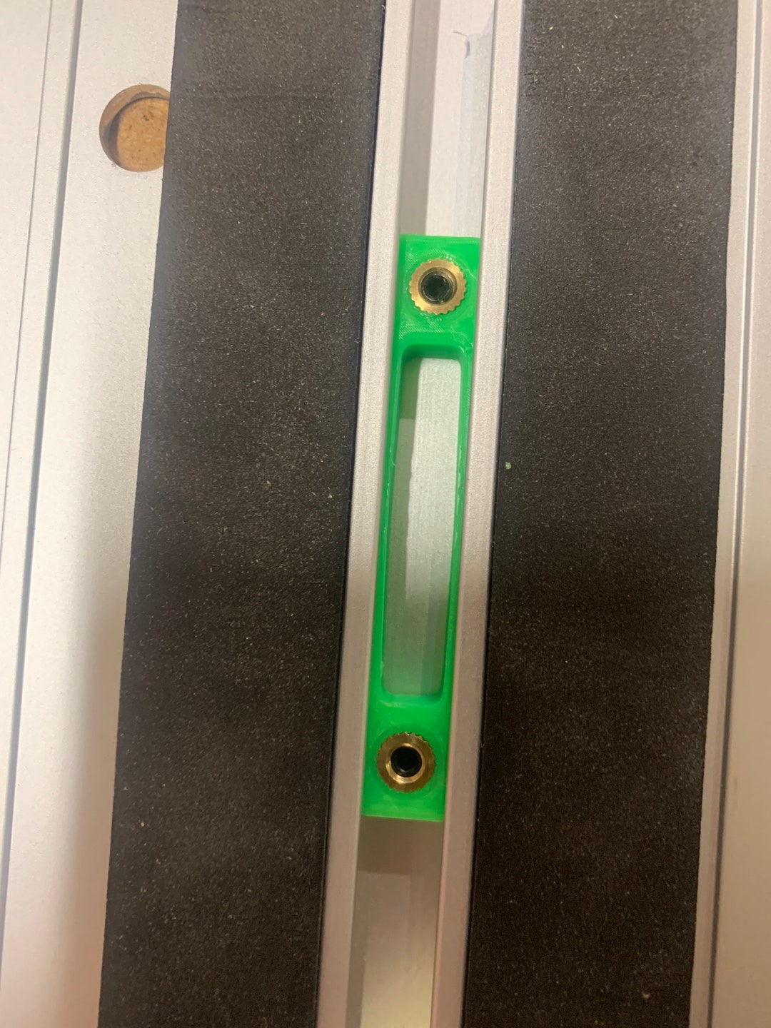

I had the same challenges when using a 12” square. I was off but just barely. I switched to a much larger Woodpeckers square. I then added a “Slop Stop” to the underside of the rail. For me the larger square solved the initial issue and the Slop Stop guides the rail onto the pin in a consistent location. These two really helped me get repeatable 90 degree cuts.

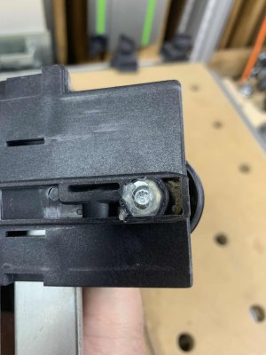

I put a tiny piece of Gorilla tape on the "pin" on the front bracket. This takes out the slop caused by the pin being just a little narrower than the slot on the underside of the rail.

I had some good results by adjusting the position of the hinge bracket so that the rail drops down on the front bracket without racking. Before that, the rail would be pulled over 1/16" or so when dropping down on the pin.

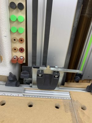

I don't even keep the front pin unit on the table. I store it in front of the rail otherwise my shorts keep catching it haha. Despite removing it and putting it back on repeatedly, I've never seen the calibration change and never had a problem with the pin 'slop'. But if someone wants to snug the pin up with some tape or something, go for it if it solves a problem. I guess I have 99 problems, but this ain't one :)
If you decide to store the pin unit like this on the back rail, pop a bit of hot-melt on the nut or it will eventually vibrate loose behind the table :rolleyes:

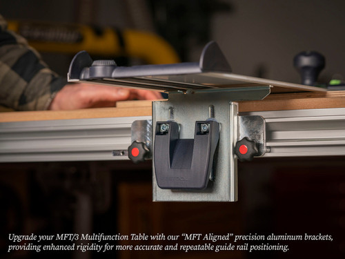

As annoying as it is, you really need to throw some (more) money at it to get consistent results. If I could have, I would have bought the basic table with aftermarket hinges, but we can only get the full set up down here in Aus, so I felt obliged to use as much of the supplied hardware as possible. I ended up getting the TSO 'MFT Aligned' set, which includes a 'slop stop' for the rail. It also fixes the problem of misalignment after raising/lowering the rail. From memory, it's about US$150, which is well worth it as it makes a big difference.
