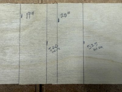

I set the fence up calibrating the measurements using the English scale, and did some test checks, and found something that didn't seem right: If I calibrated it so that 12" on the scale gave me 12 on the material, then switched to 300mm, the resulting cut would be about 1mm off. I re-calibrated it using the Metric scale, and this time the English scale was off by about the same amount. The scales seemed individually accurate, but not quite aligned with each other.
I took some pictures and sent a message to TSO support, and they replied (very quickly!) that this was a known issue, that I should stick to one scale or the other, and that I have 60 days to return for a refund if I wanted. They also said they'd share my feedback with the engineering team. At this point I am hoping that somebody in TSO will look at this and say "manufacturing defect," and get me a fence where the scales line up with each other. I really like the idea of it, and in all other respects it feels like the quality I've come to expect from TSO. As it is, I am moving towards favoring metric for all my precision wood working, so I might be able to live with it as it is.
But I am struggling to see this as anything other than a defect or a very, very questionable cost-saving choice. I'd assume that both scales are engraved on a CNC laser in a single setup, but maybe there's two setups that create the opportunity for error.
The reason why I spend the premium for Festool is that their products waste far less of my time because I don't need to work around them. The TSO parallel guides lived up to and even exceeded this standard as they didn't force me to choose one measurement system. By that measure this fence is close, but 1mm short of a cigar. I will be interested to see if they decide this is a defective product or if this is as good as it gets.
