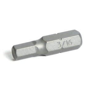

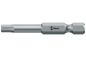

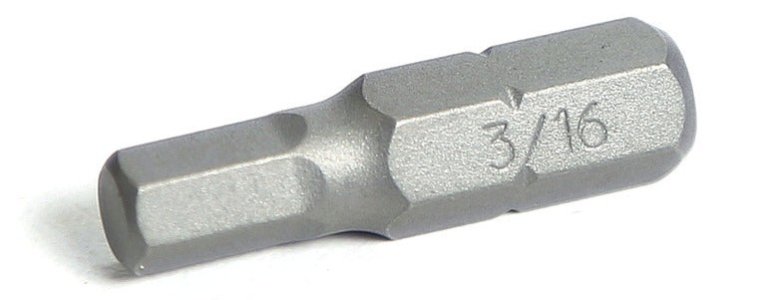

Yeah it’s a problem with the drills since they moved production to Czech Republic. It’s the spring clip rings. The sharp ends of them stick out slightly into the hex opening and get some bits right stuck in them. I use wd40 and lots of wiggling and force. They’ll come out eventually.
To be clear, we are talking about the drive shaft here. Not any of the chucks.
I’m fairly sure I’m correct. I have bits that were and are fine in my older German made drills with this style drive shaft (T18s & C18s) but i experienced the issue on Czech Republic made drills (t18, c18, cxs12)
The original cxs, and the pdc & drc drills all have a magnet for bit retention, rather than the spring clip. I prefer the magnet.
