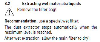

Hi all, searched a bit to see if I could dig the answer out myself, but just wanted to clarification really.
I've got a CTL MIDI, i intend to use it to suck up water. I understand I need the blue wet filter which I've ordered already, and to remove the bag for obvious reasons. My question is - does the CTL MIDI cut out before it fills up with water? Last thing i want is for it to be too full to empty.. Will it shut itself off or will I have to keep an eye on the amount inside it?
Thanks!
It's in the manual. Do you guys *never* read the manuals?  [wink] [poke]

It has a sensor and will shut off.

Apparently not - the manual is at work, with the machine, and I'll admit i was feeling too tired and lazy to look it up.
Thanks for the reply though, fast and informative as I've come to expect from this forum!
