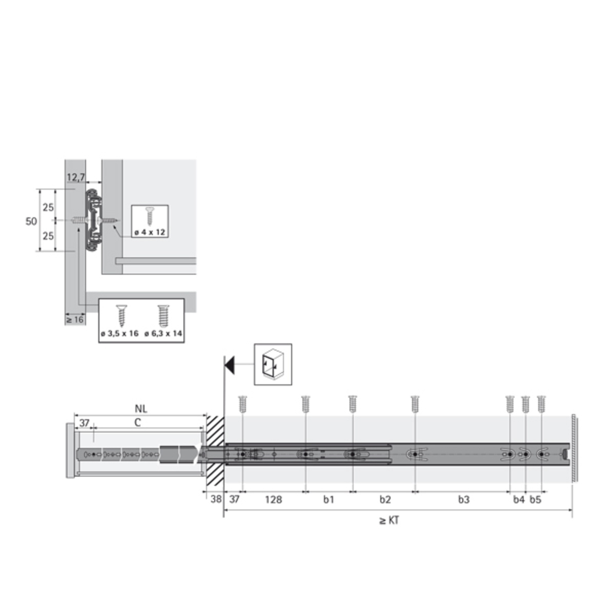

You want want to look into drawers as well, either the Festool SYS-AZ drawer or self-build drawers. Both Festool drawers and rails waste 80mm of depth; the Systainers are only 300, but both require 380 deep cabinet. With DIY build you could use 100%+ extendable drawer. I know Hettich and Blumm have those. They extend 100% + 38mm, allowing you to open a Systainer that's on the drawer.

See Hettich KA 4932. For the 300mm version; EAN 4023149413575
https://shop.hettich.com/de_DE/-/Üb...q=:order-asc:drawerRunnerType:%C3%9Cberauszug
The 38mm overextension will allow a Systainer T-Loc lid to be opened. Note that the the slides themself are 12.7mm wide and 50mm high, so you have to have some height separation or additional width.
I thought I had seen them from Blumm too, but can't find them either now. I know the Hettich was cheaper by a lot anyway.

Thanks. These look great!
For Systainers I expect to use Aluminum L profiles as "sides" of the drawer to save on width, so height will actually help with stability.
EDIT:
30€ per set, ehm, will have to re-think that for the systainers usage (normal full-extension rails are about $8 over here)
