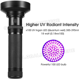

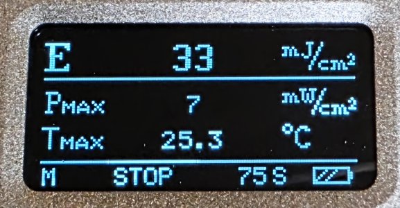

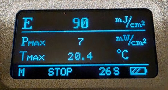

The "Crappy" Ebay 100 LED torch was measured next, and above 20mm the meter barely registered anything, at 20mm and less it peaked at 7mW/cm2. A barely anything result.
The "Crappy" Temu 144 LED Panel was measured next, and at 10mm height the meter peaked at 7mW/cm2. Another barely anything result.

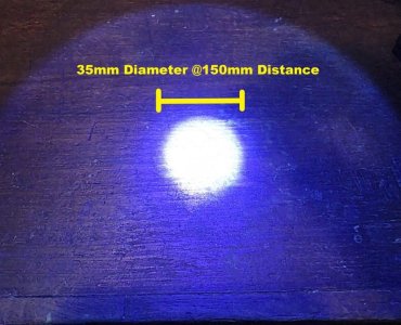

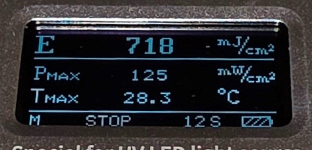

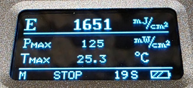

The Swiss Tech torch was next and produced really great results but with a major caveat. While it produced a very impressive 125mW/cm2, the actual working area of the beam as shown in the "Spread" pic is around 35mm diameter at 150mm distance. Moving away from the beam centre dropped to almost zero output. For small items you could work with a 35mm beam, but for boards, panels etc it's pretty much unusable.

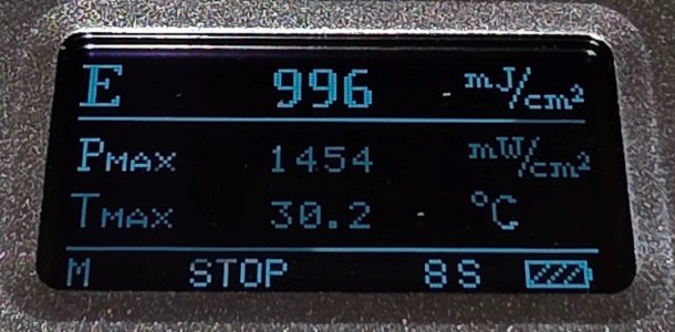

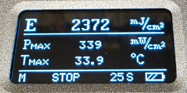

I then measured the 40 LED 800W UV from Alipress:
I was worried it would turn out to be crap, but it works a treat. At the UV Finish manufacturer's spec of 100-150mm distance, it put out a whopping 339mW/cm2. Testing has shown that 2-3 seconds per 300mm travel back and forth is more than enough to fully cure the resin. So aside from any possible faults developing, I'd heartily recommend this unit. It's quite robust too, and at 1/4 the cost of the cheapest recommended UV light source, but at least twice as powerful with a much larger UV spread, it's a bargain.

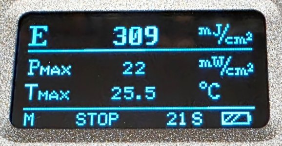

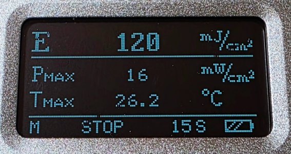

Just for curiosity, I also measured the UV output outdoors, we're in the middle of Summer in a fairly moderate Melb, at midday it peaked at 16mW/cm2, and late in the arvo it went up to 22mW/cm2. So you could cure the finishes outside, but it will obviously take some time longer.

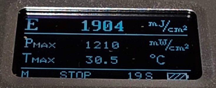

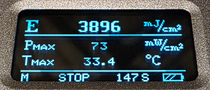

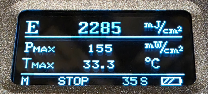

Circled in red is the 40LED (8 x 5 array) 800W light I bought from Aliexpress, and couldn't be happier with the results and price. I'll probably buy the cheaper still but longer 10 x 4 LED array one as well for a spare.
To put out 73mW/cm2 at just under 2 feet height is pretty impressive.
