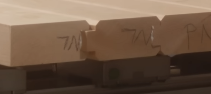

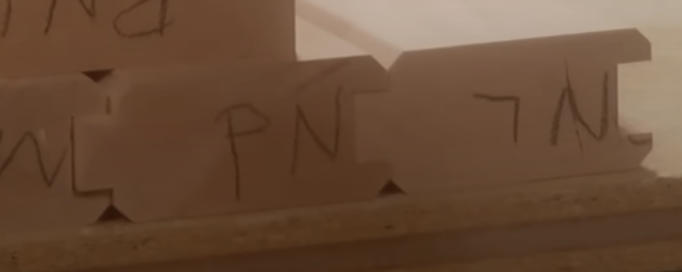

Here's a CU of the boards just stacked together:
The joint at the right doesn't appear to have a gap. The joint at the left does, but these are just stacked, not clamped yet and any clamping will close that joint down. Notice that the gap at the tongue matches the gap at the "V" notch. So any clamping pressure closes both up equally. At best they clamp and then remove the clamps to let the boards "settle" apart, but one wonders how that would actually happen.

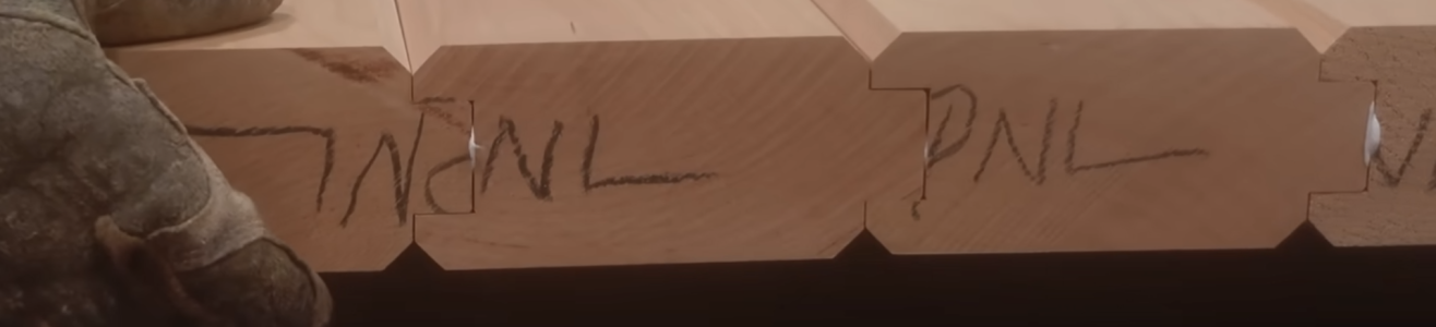

Here we can see squeeze-out as they panel is assembled, not yet clamped:

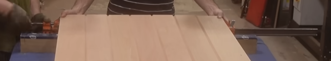

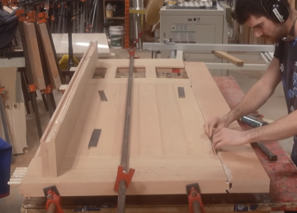

Here they are clamping the panel:
And here's the squeeze-out after clamping:

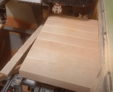

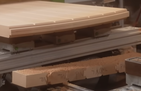

And here's after trimming the top curved edge, with the cut-off:
I sure don't see any gaps between the boards in the panel nor the off-cut.

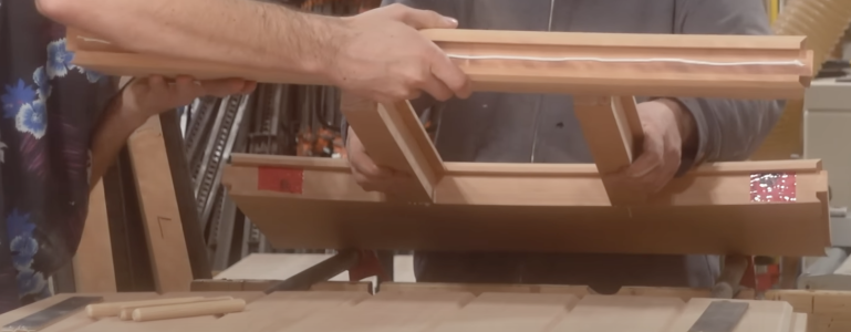

Looking at final assembly, it does appear that the final tongue milled on the panel's vertical edges doesn't stick out quite as far as the stub tenon on the bottom rail. Here's a shot, which when zoomed seems to indicate a slight recess:
IF they had designed this such that each of the 8 vertical T&G "joints" had 1mm of expansion potential, then it's possible that the total panel inside the frame could expand 8mm, and then contract 4mm. But, since these are joined so tightly together, I don't see the 1mm expansion potential - and certainly there's a limit as to how much the RTV sealant can compress (remember it was already compressed enough to squeeze-out during assembly) as the panels expand.

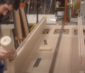

Here's the door getting glued up. They're using spacers pressed into the V notches to keep the panel centered:

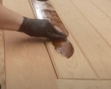

And when they're applying the stain/finish to the door itself, you can see the larger gap around the inside of the door frame while the inside of T&G boards are tight:
Maybe that gap is what, 3mm? Is that enough on either side for a 36" wide cherry panel? So, it would seem all that talk about T&Ging the center panel with RTV sealant was for naught after all. The main thing is they have a 3mm (maybe 4mm?) gap on either side of the wide panel, and have sealant in the edge grooves to accommodate wood movement. Is that enough? 36" of cherry moves ½" total in their neck of the woods, so assuming the panel is mid-width moisture content it could be OK. But, maybe not if it's dry while assembled and the rainy season is 6 months away....
Also, looking at the bottom rail in the top photo, they have six dowels in that joint, over at least 10" of rail width, maybe more like 12". And all of those dowels are glued. There's probably about 1/8" - 5/32" of movement that will want to happen in that wide a joint. Is this also a potential problem down the road?

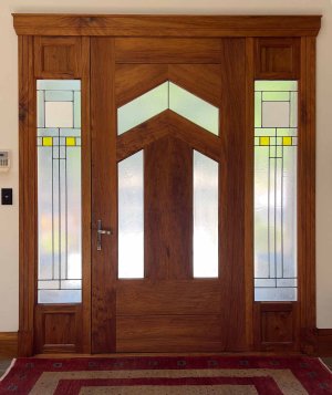

Here's my front door, built over 30 years ago:
For that extra wide bottom rail, I two-pieced it, with (unglued, unsealanted) T&G.

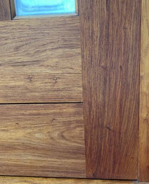

Each of the two 10.25" wide boards has two big loose tenons (DF700 wasn't invented yet), but only the top tenon of the top board and the bottom tenon of the bottom board are glued. Here's a close-up:
That gap between them can expand or contract. I did toy with the idea of putting black caulking in there, especially on the outside, but never did. The wood species is Narra, which is about as stable as teak so very little wood movement anyway. I should have made that gap no larger than half its current width, but live and learn. I would not want to glue a 20" wide board across its entire width - this construction gives me a tight bottom edge with the stile as well as a fixed top edge where the glass rests - important to not crack the glass.

The whole's just baffling to me. As you note they're using spacers between the panel and the stiles, that they then say they're using TB3 to glue the panel in which will inhibit any movement!
And they used a flexible sealant on the panel joints, and then proceeded to completely remove any expansion room.
And then it's glued in the rails, this last one is the worst for me, gluing a wide end grain panel into the rails?
I would have thought a 2mm space between each of the panel members with a bead of that silicone, could then allow 1-1.5mm expansion/contraction safely while retaining the water proofing aspect. No glueing the panel to the rails, and maybe glue in the stiles, although I'd prefer they float with some of that silicone there too myself.
My conclusion is, as @woodferret suggests, that the panel isn't TB3'ed in, but is RTV sealanted in. With the spacers, they're getting 3mm-4mm of expansion room on either side of the panel, which might be enough, just barely if the rainy seasons aren't too, well, humid for too long.
