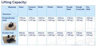

Betterley just released in October, an adapter that attaches the Grabo to the Festool guide rail. The Grabo has a self contained, battery powered vacuum pump on-board to maintain a safe vacuum level at all times. I've used the Grabo to lift and replace New York bluestone pavers in the patio. I've also attached the Grabo to textured plaster walls.

The thing about the Grabo is that it pumps down to .80 Bar and then monitors the vacuum condition and turns on again at some predetermined level. That 0.74 Bar that's shown in the 1st photo indicates the amount of vacuum that's present and it continues to monitor the decay rate/value.
I really like the safety aspect of the Grabo. The only way to lose vacuum is to lose battery charge.
