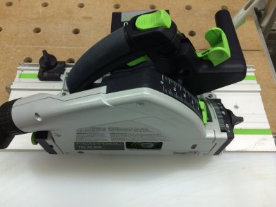

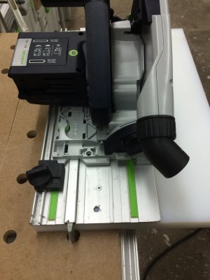

Just yesterday I used up a spare rail piece from a bent rail to make a saw toe-in alignment accessory. When the saw is upside down, it is a PITA to match a rail to it to check for toe-in/out while at the same time countering the spring .. plus the splinter guard is not exactly precise reference...
With a super-short rail piece (about 250 mm) that is also cut to remove the second "rib" that is useless for the purpose and with a removed splinter guard this works out wonderfully.

That is actually a good fit then - for your scenario - you care only for the reference edge, so there is no much need for the rib thickness to be the same. Wanting to be pedantic, one can always tighten the cams, you do not calibrate saws daily ..
Did you screw the rail section down on a block of hard plastic?

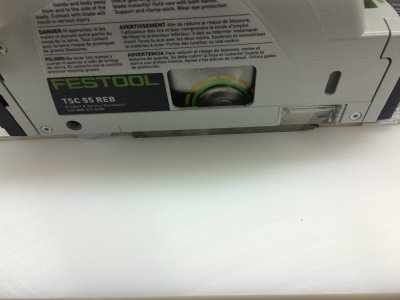

For how many saws do you use it? I have three with blades of 1.8 / 2.2 and 2.5 mm
Is that Polyoxymethyleen ?
I have 7 track saws. One is a 1.8 blade all the rest are 2.2. Which saw is a 2.5?
HDPE, it’s what I had laying around.
This will work with any of your blades as long as you reference the saw side edge of the blade. I used an R model to set it up, they gave the least adjustment.
HK85 has blades with 2.5mm kerf. Currently my HK85 cuts further out, not touching the strip at all. For what I used it for so for that's not a problem. Only on my FSK rail it touches as no other saw has used it.
That’s why I didn’t recognize the 2.5, the HK 85 is not available here.
My saw are adjusted, the 1.8 and 2.2 both hit the strip well.
