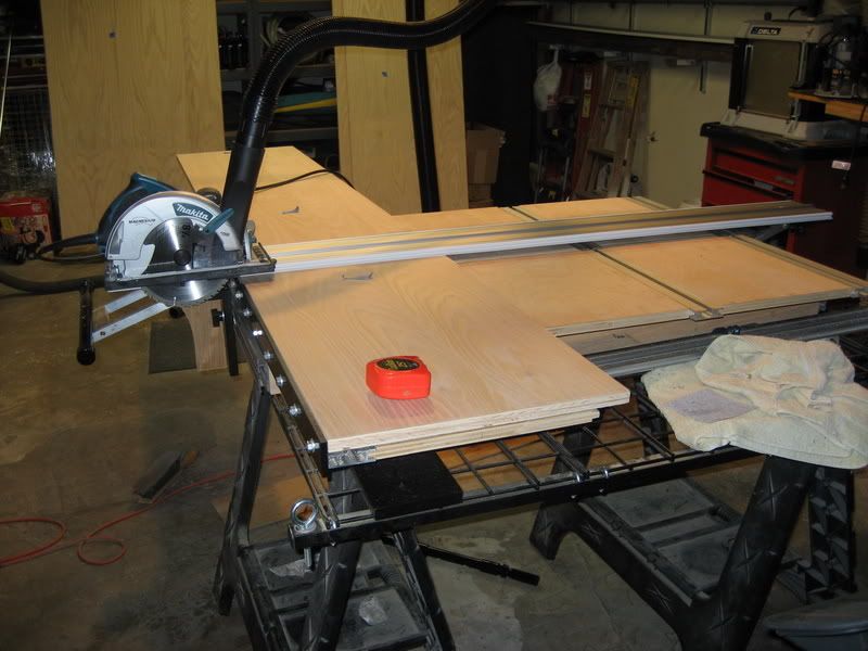

I wanted to use my new CT-33 on my panel cutting system. The short/small dia. hose that came with it just wasn't going to work. I found this 20' by 2-1/2" dia. hose on-line at Sears for $23 and it has 2-1/4" fittings at both ends that work perfect on the vac. and saw. I previously used a Ridgid shopvac and really appreciate this upgrade (never mind the boards on my bench - they are for making long rip cuts and can be removed):

Can you elaborate on the movable top?
What is the large handle under the rails?

Here is a shot of making a long rip with the standoffs on my bench:
Here is the bench w/o the standoffs:
It's a hinged assembly to lift/lower the saw guide rail:

Yeah, I saw those kits at borg/lowes but that hose is I think 1-1/2" diameter. I was looking at a hose specifically for my circ. saw rail cutting system (I have a 2-1/4" port on my saw). I drape the hose over a hook on the ceiling to my saw. It's a plastic hose but works well. For smaller hand tools (like sanders/routers/Domino) I think the Festool small dia. hose or your orange hose works well.
