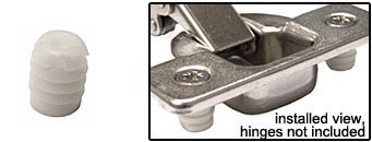

The hinges I buy come with the screws and the plastic dowels already installed. That way you just tap the hings in place with a hammer. Makes assembly much faster.

I buy from my supplier a bag with plastic 5mm dowels and the screws provided with them.
