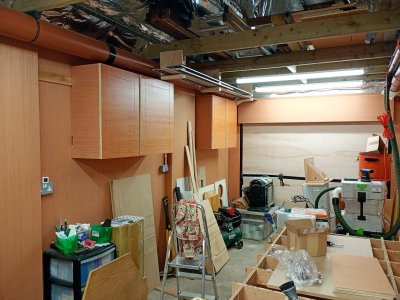

I've been making wall cabinets for my workshop.
The material is 18mm plywood.

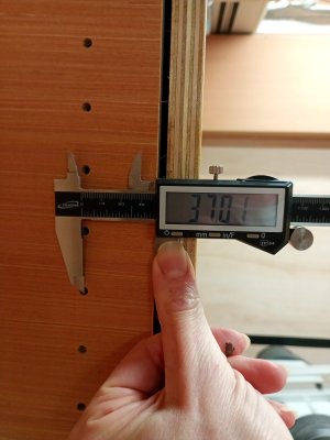

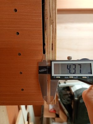

The plate mounting holes are set back 37mm. (I drilled through the cabinet sides because I plan to use the holes to mount shelves between cabinet boxes).
I end up with a 4mm gap to get the door to open otherwise the front edge of the door catches the cabinet side.
Is this right? The 4mm looks "wrong" and I need to adjust the hinge all the way out to get the 4mm gap!

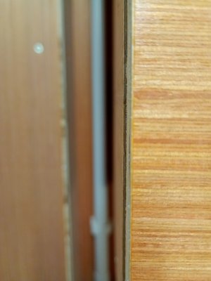

Blum requires a 1mm radius on the edge of the door.
The farther the boring distance the larger the gap between the back of the door and the case needs to be. There are various thicfkness bumpers to allow the door to close on plane.
I normally drill the centre line of the 35mm cup @ 22.5mm from the door edge and make the doors 3 to 4mm narrower than the cabinet.
These measurements have always worked for me for many years using Blum hinges and backplates.
I was aiming for a 1mm gap all round with overlay doors, the doors being 2mm narrower than the cabinet. That would create a 2mm gap when two cabinets were butted up against each other. I was testing myself to see how good I was at building boxes. I was surprised at how much of a gap there was between the back of the door and the surface of the cabinet frame. 4mm looks like a lot, but as Tom pointed out I'd forgotten about the needing a small radius on the front edge of the door.

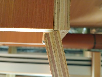

I think you will find that 2mm gap is not enough. In any place where two hinged panels are together, they will hit each other, even worse if you open both at once. You will be better off with 2mm.
The point of the gap has to do with where the actual pivot point hits. With most of them, because of the multiple links, the pivot is somewhat "floating".
If you look closely from above, like in that one pic, you will see the outside corner of the door move outward initially. Then it starts to roll in as the pivot point changes. After that, it moves back toward the box. This is exaggerated even more with hinges of greater opening capacity. Those doors actually push outward as they open and swing totally out of the way of the interior sides.
This is also how inset type hinges work. The door moves away from the side, as it swings inward.

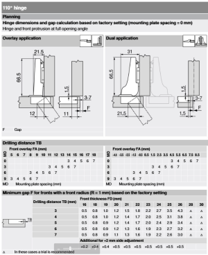

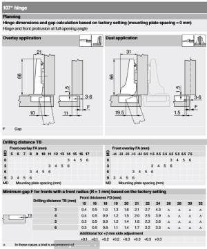

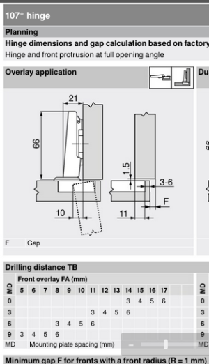

Thanks CRG. I really don't follow what's going on with these hinges. According to the blum catalogue, they should be OK.
The hinges are 107' opening, overlay type. 75T1550.
This is page 78 from https://publications.blum.com/2022/catalogue/en/78/
The bottom table says the hinges are OK for 15mm to 24mm material, mines 18mm.
The hinge plate style is "zero spacing", it's a 17mm overlay so 6mm drilling distance.
The bottom table says the min gap "F" is 0.8mm to allow opening - which it is, and the doors do open OK.
The top left picture also shows a 1.5mm gap between the back of the door and the front of the cabinet - this is quite clearly wrong, that gap is more like 4mm to allow the door to open fully.
I even made a test piece with a 6mm round over on the front edge of the door, and that still required a 4mm gap.
If I change to 110' degree 71T3550
The bottom table says the hinges are OK for 16mm to 26mm material - 2mm thicker than the 107' style hinge.
With a "zero spacing" mounting plate and 17mm overlay the drilling distance is 6mm, the same as the 107' style hinge.
The bottom table says the min gap "F" is 0.8mm to allow opening.
It appears as though the 110' and 107' hinges have exactly the same drilling positions and clearances to allow full opening.
But the picture top left shows the front edge of the door comes to rest in a different location - which it would do because the hinge is opening to 110'.
It really seems as though I'm missing something here.
The diagram clearly show a 1.5mm gap between the back of the door and the edge of the cabinet
The hinges are good for 18mm material.
But the door doesn't fully open with a 1.5mm gap, it needs to be bigger.
I'm probably overthinking this....
Bob

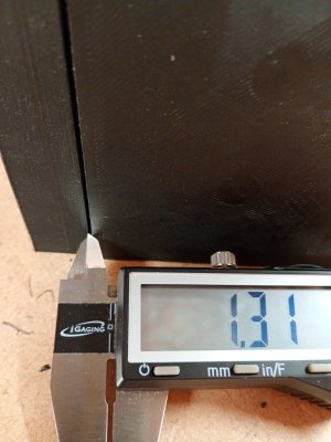

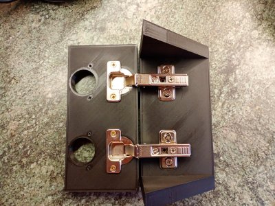

Hello FOG, Merry Christmas.

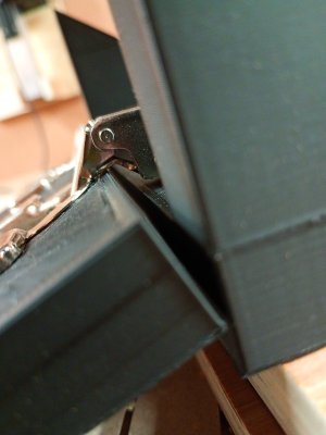

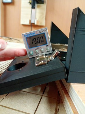

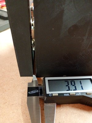

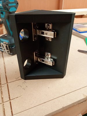

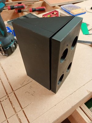

I built a jig to test different drilling positions of Blum 75T1550 hinges with 173L8100 mounting plates.
The jig is 3D printed, because I can leave it printing whilst cooking Christmas dinner and sleeping it off over night ;)
The jig is 18mm thick and has different set backs for the cup drilling, 6mm, 5mm, 4mm, 3mm (there are two different "doors"), this is the TB measurement in the Blum catalogue.
Using TB=6 and adjusting the hinge to get a 17mm overlay, 1mm reveal and so the door fully opens, I get a 3.9mm gap behind the door.
Using TB=3 and adjusting the hinge to get a 17mm overlay, 1mm reveal and so the door fully opens, I get a 1.3mm gap behind the door.
The smaller TB, the smaller the gap behind the door.
It might be something to do with how the hinge pivot "wraps" around the inside edge of the door. With a small value of TB there is a large gap inside the hinge, with a large value of TB there is only a small gap inside the hinge and I think this limits the movement.
This picture shows TB = 3mm.
This experimental data doesn't seem to match the Blum catalogue, which suggests TB must be 6 for 18mm material, 17mm overlay and 1mm reveal.
Bob
If you look at your mock-ups you’ll see the door overlaying the edge of the case creates a triangle. The farther the base projects onto the case a larger gap is necessary for the corner at the base and the rise intersection to clear the face of the case.
We adjust everything for alignment and function. I never looked or noticed that Blum put the back of door to case number on their drawings. Blum should have put a range on that dimension.
Hi Tom, the more I get into this the more I learn. I see what you mean about the triangle the door and the cabinet forms, and why adding the rubber bump stop will keep everything in line. I'm also beginning to realise the drilling patterns in the catalogues are a good starting point but need adjustment. I must remember that for the next project I take on.
