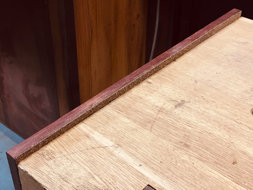

More recently, I finally added a bench stop to the end of the bench ...
This has the cork rubber ("crubber", as BenchCrafted refer to it) lining used on the Moxon and legvise. It had excellent non-slip properties (seek it out from outlets that sell gaskets)...
I love it! This stop works so well for face planing.

Nice Derek...I assume the bench stop is height adjustable? Tough to see if it's slotted.
