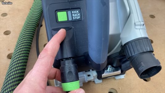

It's my understanding the TS60 has a fixed cord b/c of u.s. power regulations for removable plugs. The rest of the world has one with a plug-it cord.
I don't really care for the regulations our wonderful federal bureaucracy imposes on us, so would happily install my own.
What this means: there's certainly a plug-it adapter part available, probably from europe, unless 240v plug-it adapters have a different connection?
Certainly this can be swapped out, but is it economical/easy? Has anyone looked into what parts might be necessary? Here's the European TS60 with its plug-it adapter:

It's just a replacement part for a TS75. Any of the local dealers can order parts for you. Mine came from Highland Woodworking, because they had it in stock, at the time. The part number is listed somewhere in the original post. I have been using it, in a big commercial cabinet shop for over 2 years. Though electrical concerns are quoted, it has never been a problem. As stated, it would very likely be a warranty issue, if something were to happen. Most people would not take the risk, with such an expensive item.

It not identical, you have to modify slightly - go read the other threead it is documented on EXACTLY HOW to do it in fine detail. It took me about 20 minutes to do the procedure. If I have a warranty issue, it is about 20 minutes to put everything back the way it was.
The only time it would even remotely be a concern is cutting max depth hardwood or maybe pinching a blade - if you plunge and run to full speed before entering wood, it would take an unordinary thing to make the wattage max out as it has a soft start anyway.
I decided I no longer cared when a guy uses it in a production shop for 2+ years with no issues and that poor saw has already seen more hours than mine probably will before I die.

"They" didn't use anything. The 120v model never had one. Even the UK 110v has a fixed cable.
This is simply a modification, using other machine's parts. It's not an exact-fit, the spade connectors are different, and need to be changed.
Again, I don't recommend this. I did it to a tool that was already out of warranty.

I mean to say, if you look up the parts diagram for a plug-it TS60, it'll have the differences and the parts can merely be bought. This is an extremely trivial thing to do, like easier than legos. The risk of running too much current through the plug-it cable I am entirely unconcerned about, based on both what you've reported, as well as what I know about electricity.

I nominate you. How many times do people have to spell out you have to use the part from the 110V TS55/TS75 ? Oh and leave Christ out of it.
