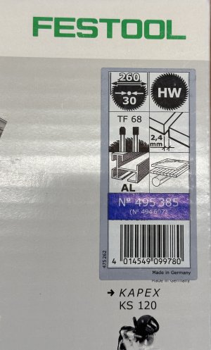

The Festool 494607 Aluminum blade for Kapex 120 is not available in the USA, not sure why. I cut Aluminum frequently enough to have a dedicated blade. I realize that folks use a regular fine tooth wood blade but I feel I would want a fresh wood blade for when I really need it so might as well buy a dedicated aluminum blade.

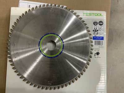

The Festool blade for aluminum I have is a different number (495 385). Possible number change at some time? I am in the USA.
I have the same Festool aluminum blade as Tom. It was purchased back in 2016 from Amazon. The old number was 495385 while the new number is 494607. They are the same blades with the same specs, I'd take a look at Amazon just for giggles.

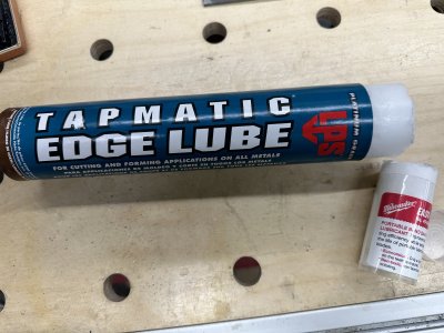

Like Michael mentioned...make sure to use some dry lube...I use this stuff.
