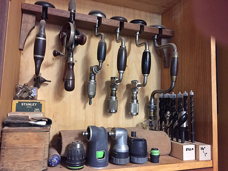

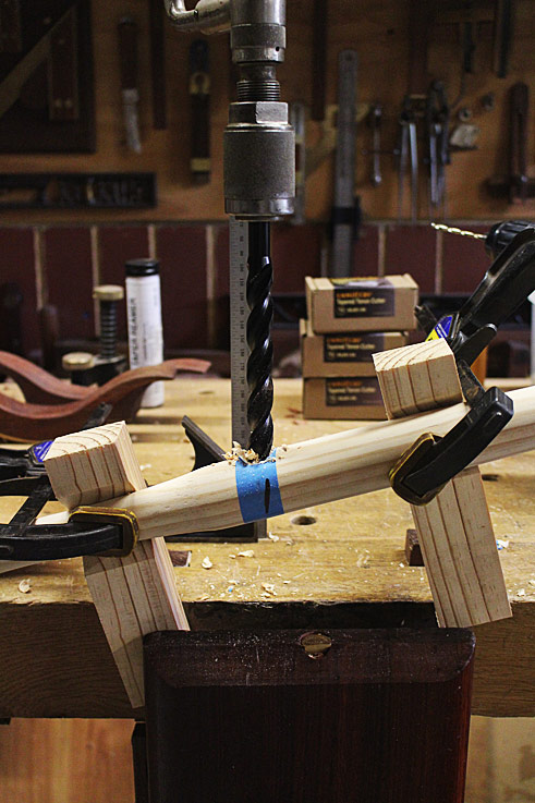

A brace and bit(s) will be incredibly useful! Far from being a vintage and archaic tool, in the right conditions, they will out-drill even my Festool 18/4 PDC.
Braces come in a range of sized (referred to as "swings") - from 5" (useful as a driver and, especially, for countersink bits). A 12" swing will turn large bits (1 to 1 1/2") far more easily than you could drill with a cordless.
Russell Jennings bits ...
Irwin bits ...
Morticing legs ...
Dog holes in a bench top ...
