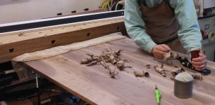

I  edge-joined (glued dominoes) the planks within 48 hours they were thickness-planed, so the glue-up was pretty flat to start with. (As a standard practice, I do not alternate the boards (no washboard effect)).  I checked for flatness/any high spots, and planed where necessary (photo shows the underside being worked on. The blade in the LAJ was honed at 40* (38*+micro bevel) to reduce the risk of tear-out).
