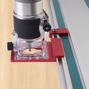

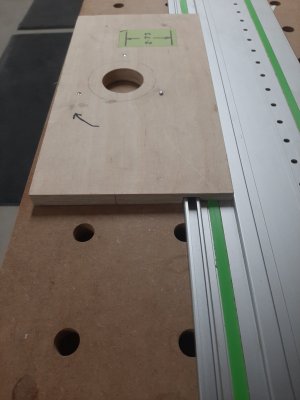

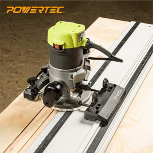

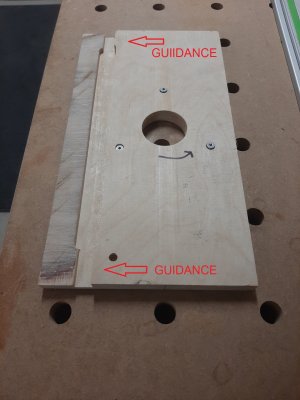

Pretty easy really, there's a number of ways you could achieve that. You could use the rods from the fence and make a block of wood or metal to ride the top of the rail, or make a flat base with some additional material to ride the groove as in the pic below. The second one I would think more stable for a larger router.
