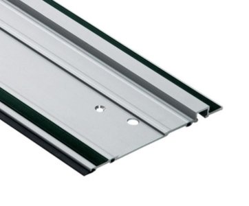

Mafell does offer a Holey Rail...207601. Photo 1
The Mafell rails really are the best...my favorite for sure.

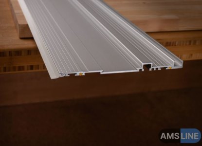

You forgot to mention the dual clamp tracks on the bottom of the Mafell rail which allows you to easily cut narrower pieces. Photo 2
