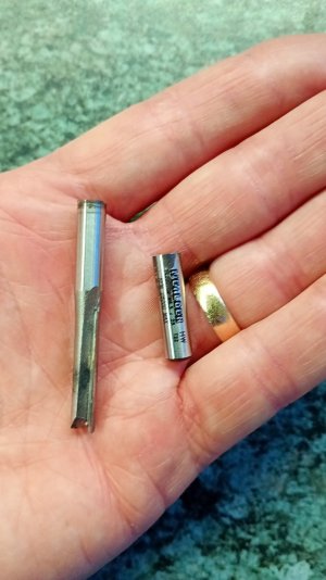

Why did I break this router cutter?
It's 1/4" diameter 73mm long (3" long").
I was cutting 6mm deep into plywood and moving the router pretty fast, using the OF1400.
The chips were actual chips, not dust, so the cutter wasn't burning. It was vibrating.

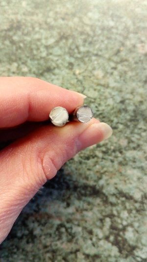

When it broke the cutter was hot and there appear to be "burn" marks on the length that was jammed in the collet where the collet clamped on to the bit.
The collet wasn't tight into the router after the bit had broken - this surprised me because it was definitely tight with I put the cutter into the router!!
I think I was being far too aggressive with the cutter (I was rushing) and was cutting too deep and moving too fast. The vibration from the machine should probably have given me a clue.
Am I right in my thought process?? Being too aggressive?
Bob

View attachment 382016View attachment 382017
Bob

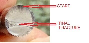

The vibration was definitely the point where you stop. The bit was loose right then. Continuing to run it probably worked it out more, increasing the leverage/load. Be careful when you put it back into service. It is possible to permanently damage a collet doing this. Breaking is better than it coming out, but it is worth checking.
A new frequency vibration, or a new sound emitting from your tools are warning signs. Stop what you are doing and find what is causing the change.
It is almost never a good idea to continue as if nothing had changed.
Thanks guys, I really should have known better than to keep on going with it. I'd gotten into "the zone" and was batching out brackets for a cleat wall I'd been working on, I must have made 8 or 9 of the things by the time the cutter broke.
