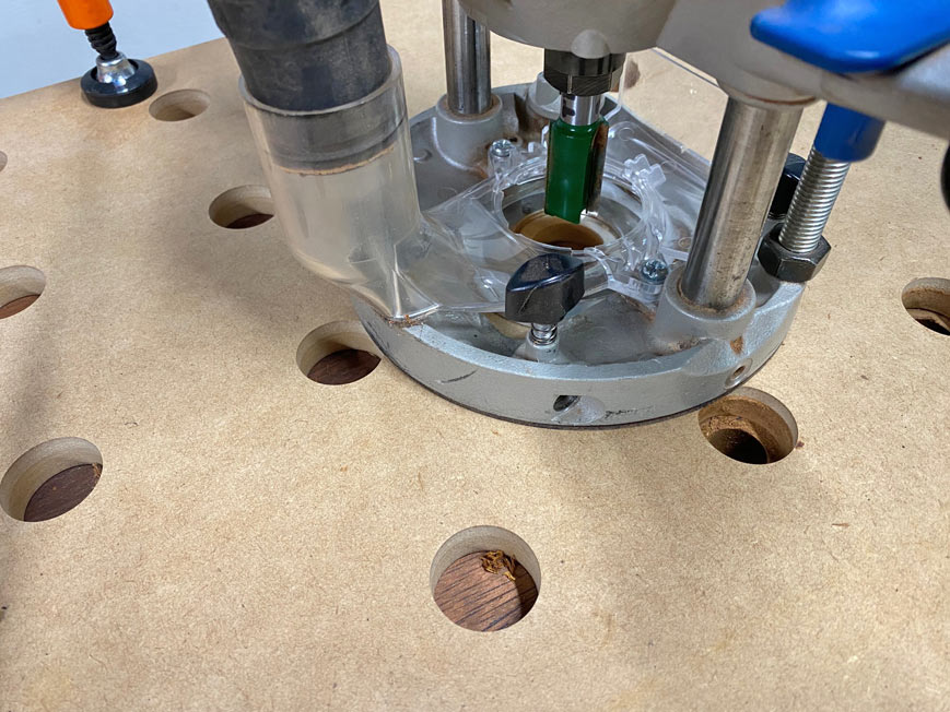

There are basically two methods to make one's own: the UFK Parf guide (drill), and the Trend template (router). The cheaper Trend template is $300 in Australia. Fortunately, I was offered the opportunity to make a template by a friend with a CNC. This went one better than the Trend, by doubling it in size. The template has 30mm holes and is used with a guide bush and 20mm router bit to create the 20mm holes.
The bench top was prepared by ensuring all sides were square, and then the template was squared to the front and right side ...

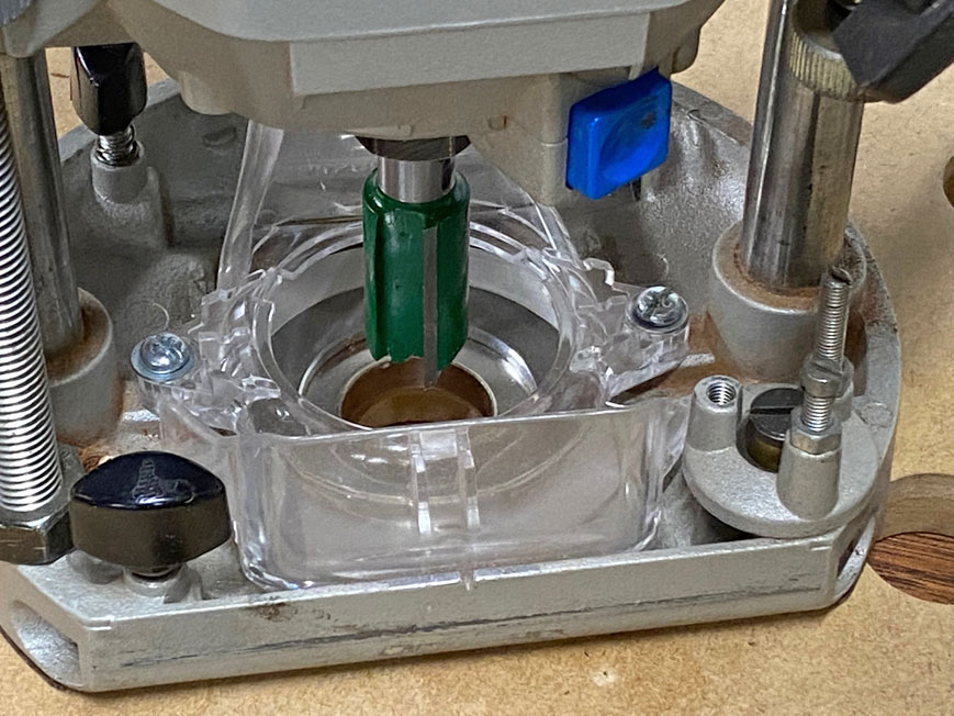

My old Elu router is at least 25 years old. It used a 30mm Trend guide bush fitted into a custom made adapter ..
The router bit is a Trend 20mm ...
I was also very pleased to see how well the dust collection worked. The Elu did not come with dust collection - this was not important 25 years ago! - and I adapted the fitting from a Dewalt to fit it.
