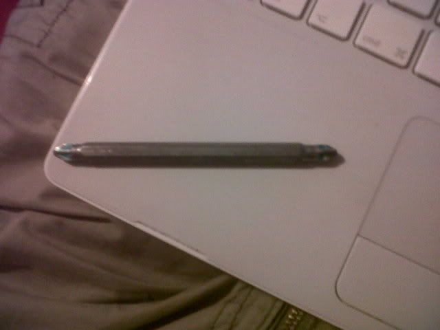

I know they are different pozi but normal Pozi do scew them in also.  What do you mean by double ended?!?!? you mean they are longer?! The ones I use only have one end on them.
i have snapped no end of pz2 bits with them, i know they drive them but i think it strains the bit more
we get 1 of these and about 5 @ 50mm like that in the multi packs
Must be different Ultimates then!  Do your boxes look like these
These are the bits I  get with the boxes all ways have done never seen them double ended one with ultimates.
[attachimg=#]
yes they are the same screws but as i said before i get the multipacks that come in a case and they have the double ended bits,  i had some of those but all snaped now
