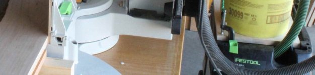

I know you don't plan to use the Kapex with a cyclone. I use the Kapex a lot, and the dust deputy is indispensable. I just empty the bucket and clean the HEPA filter (https://www.leevalley.com/en-us/shop/tools/workshop/clean-up/70445-vacuum-filter-cleaning-wand?item=03J2430). The vac drum itself won't get filled up in 15 to 20 years of heavy use!
However, do get a CT26 if you conclude that a Festool extractor is a better fit for your shop. The Kapex is good at collecting dust! [big grin]

Yes, don't opt for cheap auto-switches. Fire hazard alone, they often don't support the load required. The iVAC switches I quoted are ELT-listed with a built-in circuit breaker which can be reset upon overloading. I've been using two of them, one for over 5 years (Kapex + shop vac) and another 7 (SawStop (1.75HP)+ dust collector for under-the-table collection + shop vac for overarm dust collection).
I highly recommend the iVAC switches because when "us[ing] both cords in separate circuits for greater capacity (30 amps maximum)." Most other auto-switches I came across provided a 15amp circuit. And, the iVAC is only $50 US each...and free shipping.
By the way, I started with a CT26 for the Kapex, but sold it after realizing that its mobile feature was not used and the bag couldn't keep up with the amount of sawdust my projects produced. I had to use a DD, which means any shop vac outfitted with a HEPA  filter could do the job.
