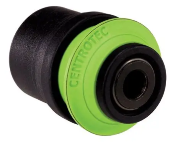

I have been a big fan of Festool and decided last year to start replacing my DeWalt battery tools with Festool. I bought a CXS 12 and love the drill, BUT I hate the chuck for centrotec bits. I have consistently had difficulty getting the Centrotec bits to lock into the collet. Festool sent me a replacement, love their service, but the issue remains. Additionally, I have broken 2 of the chucks removing a screw. Probably shouldn't have used the CXS 12 for the screws but I guess I would hope the drill would sense the torque and stop instead of instantly breaking the internal components of the chuck. I have used DeWalt for years and never broken a chuck or had difficulty inserting bits. Has anyone else had these difficulties?

I have never heard of an issue with a Centrotec chuck, nor have I experienced one with my own tools. Do you have a picture of the broken chuck, or can you describe what/how it broke? I'm really intrigued.

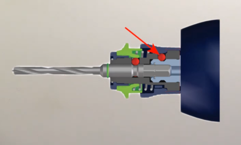

Are you sure they are being fully inserted - on a Centrotec bit, it actually goes in so far as to go into the drive of the drill/driver - the piece you pictures does nothing but hold the bit from falling out and makes it easy to swap.
If you are using standard 1/4" impact bit and filing them down or grinding, you are on your own and results will vary across the board.

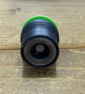

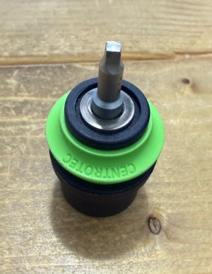

Here is the picture of the bit besde the chuck, inserted and the backside of the chuck showing how far it goes into the chuck - you can leave them like this and swap chucks on the machine (I prefer to swap chucks rather than bit because I think it is less "figiditty" Also, in this configuration, properly inserted the bit spins freely inside of the chuck.

I personally love the system and use it as exclusively as I can. In the rare moment that something comes looks, it's because it wasn't fully inserted into the Centrotec chuck. The tooling actually goes beyond the chuck and physically into the hex shaped drive portion of the drill/driver. I've also never broken one of these and I push the limits of my two CXS drill/drivers (original version) as well as a CXS18.

I started out with the CXS 12 and, like the others, I've found the CentroTec to be a very good system (just wish the bits were cheaper). But like you, I did have some issues getting the chuck to seat fully - especially if I took the whole chuck off (with bit inserted) and tried to put it back on. Unless I really checked to make sure it was seated, the collar wouldn't fully lock. I learned that it was a matter of me reorienting the chuck until everything seated, or take the bit out, seat the chuck onto the CXS 12 and then insert the bit (and make sure it locks).
