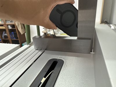

Hi All could you help me to figure out how this problem can be solved?
I looked everywhere for some screws to turn but found none that worked…
Thanks!

It stays at 90° by design — there’s no adjustment.
The fence base is machined square to the table, so when you clamp it down it self-squares.
The second knob just locks the aluminum extrusion in place so it stays tight and doesn’t move.
If the fence isn’t at 90°, it’s usually because it wasn’t fully seated, there’s dust/debris on the table edge, or it wasn’t clamped evenly. The fence itself is designed to self-square and has no adjustment.
Thank you for your kind reply
But No,mine definitely not 90° there is no debris or significant dust anywhere. I just had to use bluetape to shim up. Disappointed with festool since this is not first quality control issue with brand-new festool I had the misfortune to encounter.
Did you check if the fence itself is square and the table top is flat across? If both are, the problem may be with the mounting/clamping hardware.
Does that look like an unusual amount of wear/grind marks on the fence? I don't recall mine looking like that?
