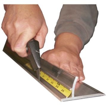

Aluminum and copper flashing is easily cut by scoring the cut line with a utility knife and bending the metal along the line.
This works with most flashing, but if the copper or aluminum is dead-soft, it might not or it might require a deeper than normal scoring.
I used aluminum flashing for my skylight.  It was light, easy to cut and fairly inexpensive.
I’ve never tried this with galvanized steel flashing and if I did, I would probably try using a carbide scoring blade (usually used to score Formica sheets).  I would try that first.
Scoring + bending has some obvious benefits:  Quiet, dust-free and no special machinery required.
Minus:  A knife blade can climb the straight edge and cut your hand.
You can mitigate the risk by using a special straight edge (see image below) or by mounting a piece of 3/4” x 2-1/2” hardwood to the center of a conventional straight edge.

As it turns out I have a small roll of 20” wide aluminum flashing (0.0105”).
This is the equipment I used to cut across the 20” dimension:
And here is the score line I made (pressing hard on the blade):
And here is the break in the material after scoring.  The break is as straight as my score line.  I don’t think I could equal that cut with a saw.
The flashing I have is fairly stiff and snapped cleanly.  Very soft material would be much harder to cut using this method.
But do note I was using a straight edge with a vertical safety barrier.  If you are pressing hard on the blade it can climb the straight edge—a risk that can be avoided by screwing a vertical barrier to your straight edge using small screws and counter sinking from below.
I was neither careful nor deliberate.  [big grin]
NOTE:  The cutting surface I was using to cut the aluminum is a sheet of 44” x 44” glass.  Above the glass is a two tube fluorescent light fixture.  The reflection on the glass looks like something is on the surface.  But the only things on the surface are the aluminum, the knife and the straight edge.
