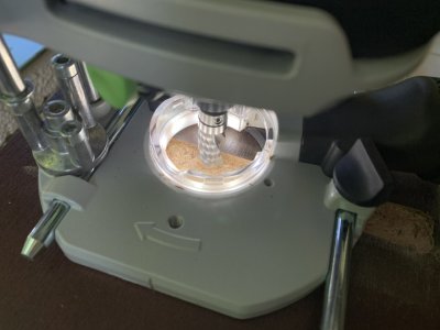

Just for a little history, I come from a background of owning several Milwaukee routers which have always used 1/2" diameter bits. I have quite a supply of them so my first Festool router was the 1400 because it accepted 1/2" bits. It's a great router...but then I became introduced to the 1010 and the story changed suddenly, it's so nice and light & compact. The new 1010 R router also accepts the LED light module, 578055.

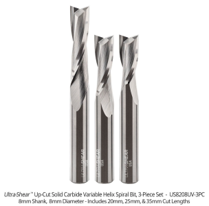

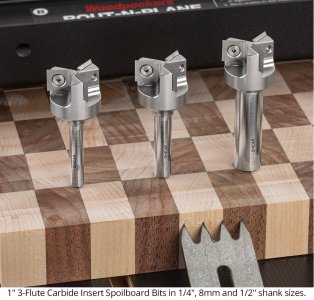

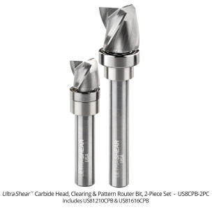

Out of curiosity, what's the price of 8mm cutters like in the US?
8mm bits have always been difficult to get because I had to order Festool or CMT bits from Europe. However, about a year ago Woodpeckers started to grind their own 8mm bits and offer them for sale. Here are some of the current Woodpecker 8mm offerings.
For the solid carbide bits, you pay more for the 8mm bits because the carbide rod stock is a larger diameter than the 1/4" carbide rod, while for the spoil board bits all 3 sizes are the same price...$60.
The pattern bits also vary in price again because of the diameter of the carbide rod stock.
