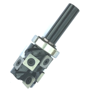

8mm bits have always been difficult to get because I had to order Festool or CMT bits from Europe. However, about a year ago Woodpeckers started to grind their own 8mm bits and offer them for sale. Here are some of the current Woodpecker 8mm offerings.
For the solid carbide bits, you pay more for the 8mm bits because the carbide rod stock is a larger diameter than the 1/4" carbide rod, while for the spoil board bits all 3 sizes are the same price...$60.
The pattern bits also vary in price again because of the diameter of the carbide rod stock.

8mm shanks are considerably stiffer than 1/4. For some jobs, it not a huge thing, but I prefer 8mm whenever I can get them. A few years ago, it was harder to get them in the US, but has gotten better. I do wish we were able to get the much more extensive selection that is available in Europe.
They are a little more expensive than 1/4", but it's a combination of more material and higher end brands.
I use Woodpeckers, Lee Valley, and Bosch mostly. Like I said, the Festool ones are not available here. (a few that fit the MFK700 are, but that's about it)
