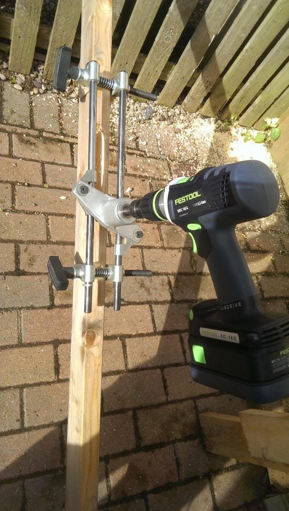

Deansocial said:Id say for single locks it would be fine but nothing more than that. You deffo need the speed over torque.
jmbfestool said:Speed is more important than torque.
The way you use the Souber jig is by taking layers of the face bit by bit as you move up and down which requires little torque.
The bits on the Souber are designed like a router bit which require high speed because they don't have a very aggressive cutting action. This is to avoid any grabbing by the bit as you move up and down which could cause damage or cause the bit to try and stray.
So the faster you move up and down and the faster the bit spins the better. Then slightly plunging deeper and deeper as you move up and down and not trying to force it as deep as possible.[/b]

Deansocial said:Used mine for eleven locks today. Worked fine all in a single charge.
