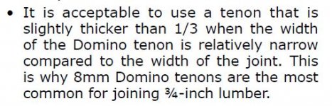

Pushing luck -- not at all. I'd do it even if it were 16mm in thickness unless some specific joinery strength is at stake. The 1/3 rule applies more to softwood than hardwood, and is a guideline only. I break it now and then with no negative consequences or failures.
For 3/4" (19mm) lumber, the manual says 8mm dominoes are totally acceptable. They're what I normally use for hardwood stock unless the build is light weight.
"...when the width of the Domino tenon is relatively narrow compared to the width of the joint."
hmmm. 8x40 Domino is 22mm wide, and the joint is 38mm, I think I'll do a test joint first.
