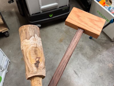

Yesterday, I thought that I would make a couple of mallets. One of white oak and the other of Black Locust from a branch that I cut off the tree that fell in my yard earlier this summer. I got the idea from a Japanese woodworkers' video I saw on YouTube. He was more masterful with a chainsaw and a hatchet, I had my old 1934 Delta 14" bandsaw. I scored a line around the center and started cutting away the handle with a Carter Green Wood 3TPI blade. Overall, it went well. I would cut a slice off along the length of the handle and then, if the center line wasn't deep enough, cut the slice from the piece. During one of those crosscuts, I jammed up the piece and stopped the saw.

These are the mallets so you can see the size of the Black Locust.
