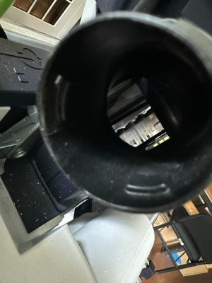

I recently got the Kapex 120 and have it connected to a midi ct. I did a test cut and thought it was odd that I had so must saw dust on the plate and floor. I turned the hose on and placed a couple of chips near by and nothing is being extracted. The tube connecting to the blade seems to be clear. Thoughts on what I'm missing?

I took the video after I vacuumed the dust that was on the plate. I also checked the midi and the bag is half-full.
When I made the test cuts I cut down and into (towards the back) the 2x4. I was very surprised at the amount of sawdust. Much more than with my Makita 1218.
Thanks for any insights.
Could you make a test cut with the extractor OFF and see there if there's any difference in the amount of saw dust seen on the table and floor?
Great, simple, and brilliant suggestion-thank you! I just did a couple test cuts and was rather surprised and disappointed by the decent but not great dust extraction with the midi turned on. Maybe I was spoiled by the Makita. Thanks again.

Here's another thing to check. the suction setting on the vac. Sanders like it fairly low and the saws like it full blast. If you were sanding before maybe it is still set lower.

Thank you so much! Yes, my dust extraction was set to the middle. I haven't done another test cut but I bet that simple obvious thing will help a lot. Thanks!
