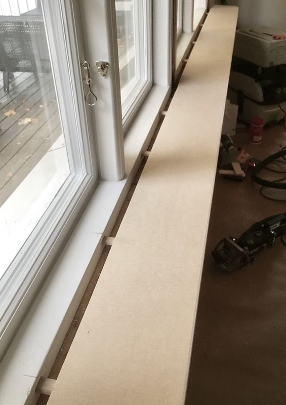

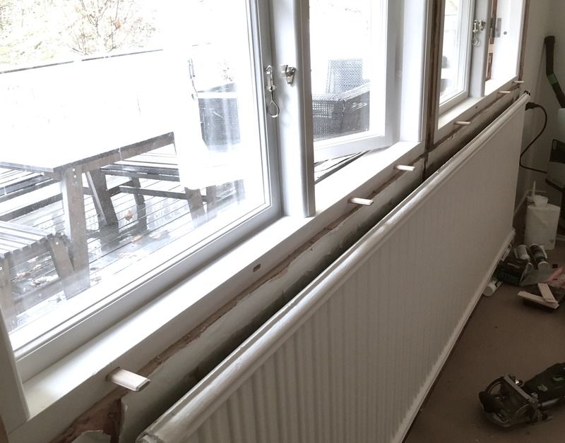

On the inside the window sill was running the entire length across four windows (two double hung windows side by side) so I decided to use large dominos and attach the window sill on site and trim the sill along the wall with the RAS115 after dry fitting. The wall wasn't all that straight it turned out. I marked the sill according to the window openings and adjusted the sill so it would sit some 5 mm down from the window frame to allow for caulking if needed. (Turns out fit was so good none was needed ;) ).
This way I could replace the hideous existing sill and replicate the older style sills without removing the radiator.
I find the XL even more simple to use than the DF500 but I did use the DF500 to fit the Dominos to the window frame and had deeper Domino plunges on the sill using the XL. Once I had marked out the first two/three I could dry fit and mark out the others and start trimming it to size.

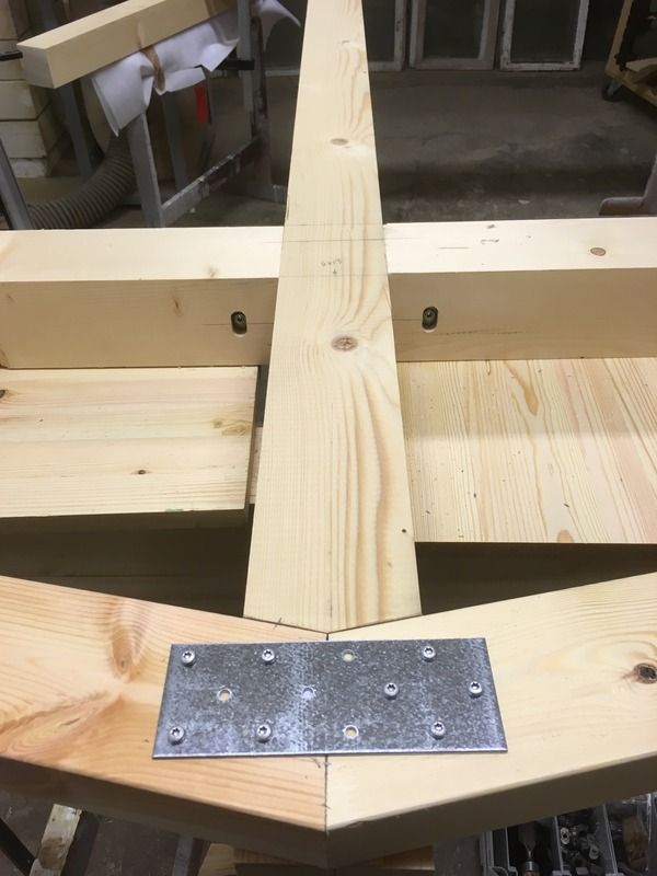

Frame is 95x95mm spruce and we used the Domino Connectors for the joints:
The joints are two 14mm Dominos for support/strength and one connector (different orientation). The whole structure is 6m by 3,2m and 2,6m high and built so it can be disassembled when the agency is moving in two years time. Although a bit sceptic at first, the joints turned out to be very strong and the synergy of the components makes for a sturdy construction. I would not have built it like this for outdoor use though. For indoors it is more than strong enough.
