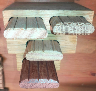

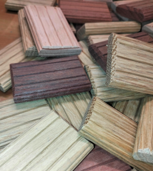

@Stevenski Since you're getting the Domino, no doubt you'll be buying the tenon/cutter starter set if you haven't already, but also check out findbuytools for the dirt cheap matching mortise, as well as the tenon cutters so you can make your own tenons if you have a router table.
Other than for exposed mortises, why is there a need to have matching Tenon Cutters?
As long as there is long-grain to long-grain glue-up, will a Rectangle-shaped loose tenon be plenty fine?
A: Because they're pretty!
B: Because they match the glue-groove profile of the Festool tenons
C: Because you can make them in any timber up to the max width of the wide setting
D: See A
Seriously though, being able to make them to suit the widest mortise setting is amazingly useful, especially so for the DF500 as there's quite a bit of difference between narrow and the widest settings.
I use mine for alignment and strength, greatly increasing the glue surface area, so if you only really cared about alignment then square tenons will do perfectly fine. My miniscule level of OCD would never allow me to do that though unless under exceptional circumstances. ;-)
